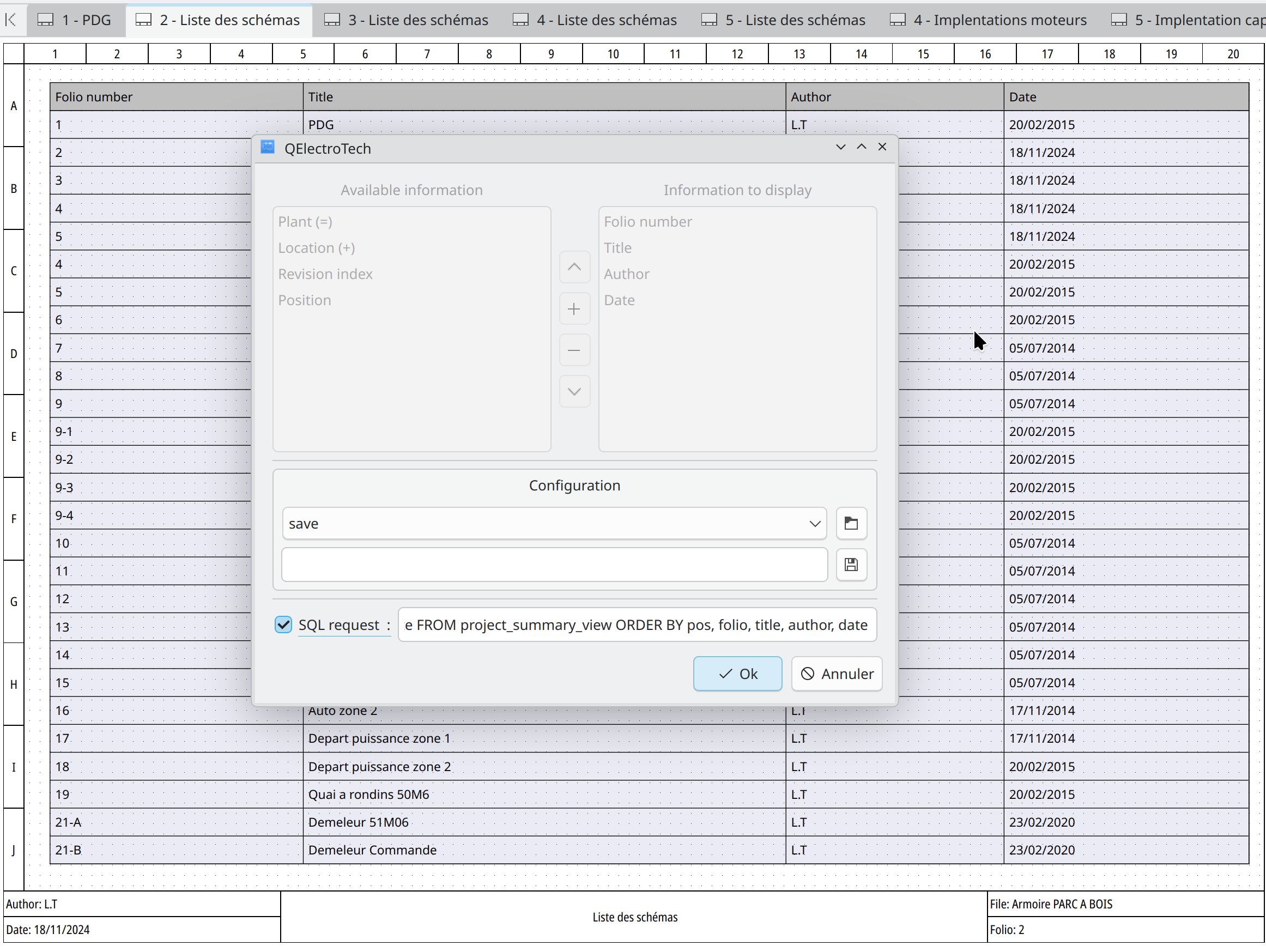

Hi Guys !
How can I sort by page number?
I tried, but they are out of order.

Set the 'Page' column first, or adjust the SQL query
SELECT folio, title, author, date FROM project_summary_view ORDER BY pos, folio, title, author, date

Hi Laurent,
I defined an user-property which is used on each folio. How can I use it within the SQL command?
If I just change your command into
SELECT folio, title, date, status FROM project_summary_view ORDER BY pos, folio, title, date, statusit only shows a little grey box.

Hi Joe,
export your database and open it, you can show if your user-property appears?

Hi Laurent,
thank you so much for your help. It appears that the custom value (see attachment) is not being saved in the database. Is it being saved somewhere else?
