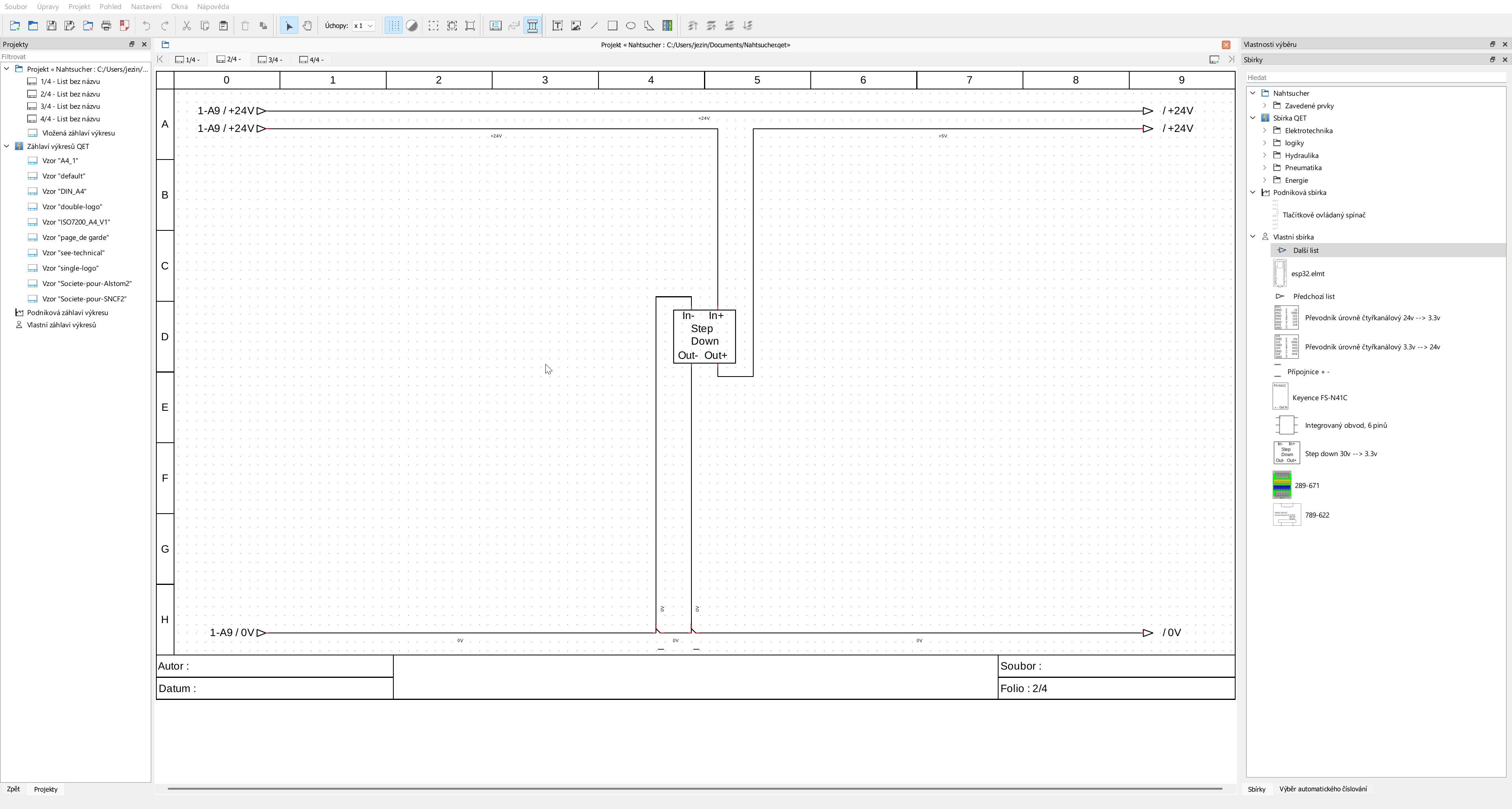

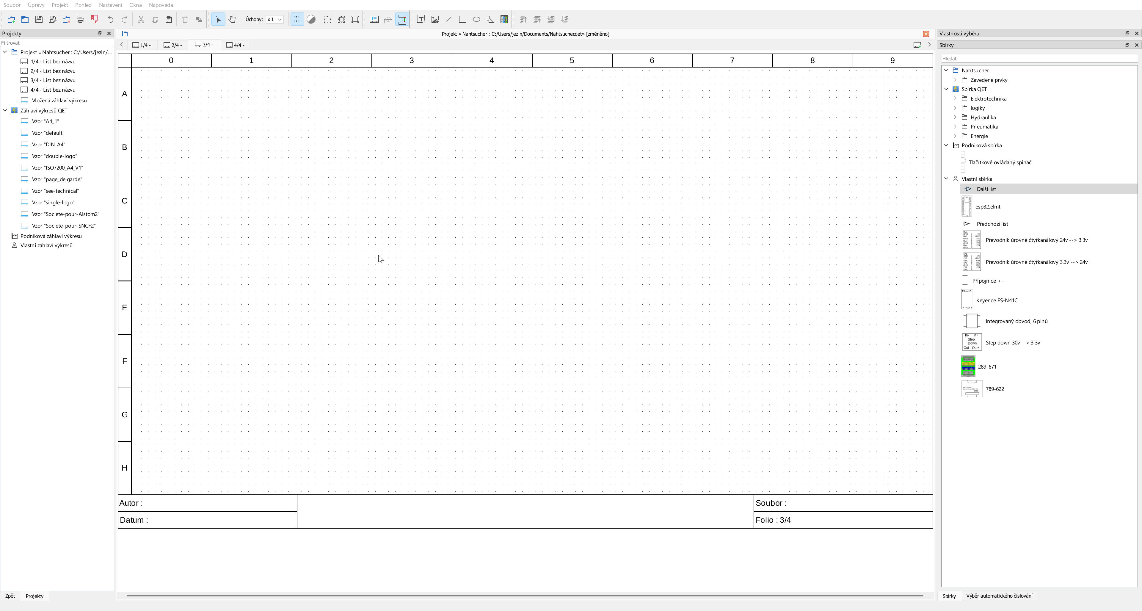

I recorded two example videos (GIF) showing that the behavior changes even with the same settings.
In one case, the mixed text remains after copying; in the other case, it is cleared and the text box position shifts.
This difference occurs with the same procedure and the same settings.
Jiri

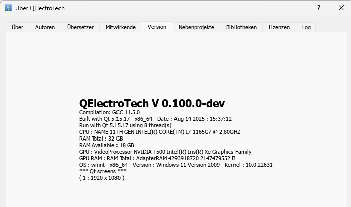

You did not say, what OS and version of QET you use!
Menu -> Help -> About QElectroTech -> TAB "Version"
For me, copying and pasting reference elements works and the texts are placed in the right position on win and Debian Linux!

However, there is still the issue that after pressing Ctrl + C, the labels on the links appear to “disappear” – their alignment and position change, so they are no longer visible in their original place, even though the links themselves remain functional and connected. Would it be possible to address this so that the label positions remain visible after copying?
For reference, I am using the latest version of QElectroTech (installed yesterday) and fully updated Windows 11:
QElectroTech V 0.100.0-dev
Sestavení: GCC 11.5.0
Built with Qt 5.15.17 - x86_64 - Date : Aug 14 2025 : 15:37:12
Run with Qt 5.15.17 using 8 thread(s)
CPU : NAME 11TH GEN INTEL(R) CORE(TM) I7-1165G7 @ 2.80GHZ
RAM Total : 65 GB
RAM Available : 46 GB
GPU : VideoProcessor NVIDIA GeForce MX350 Intel(R) Iris(R) Xe Graphics Family
GPU RAM : RAM Total : AdapterRAM 2147483648 2147479552 B
OS : winnt - x86_64 - Version : Windows 11 Version 2009 - Kernel : 10.0.26100
*** Qt screens ***
( 1 : 2560 x 1600 )
( 2 : 3840 x 2160 )
( 3 : 3840 x 2160 )
