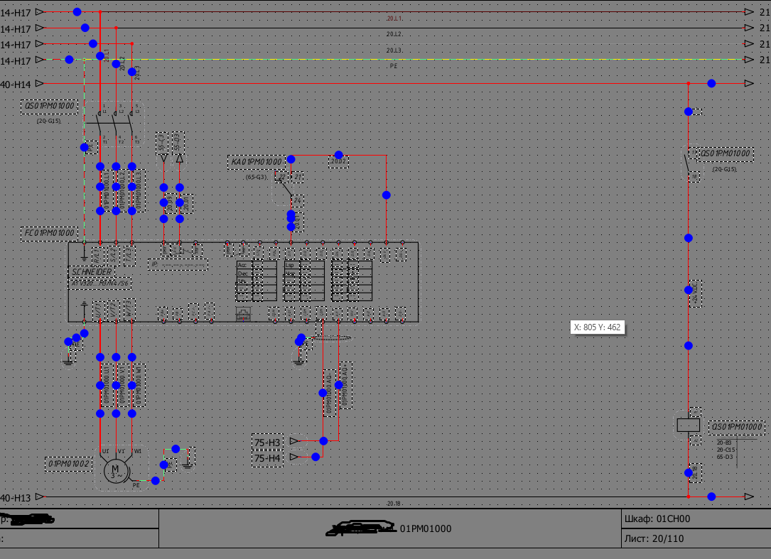

It's possible to make copy-paste of elements like copy-pase as elements
i mean, if i'll copy a few elements with conductors
conductors are save %{id_conductor.%num}
but elements are not save %{id_motor}
pic1.png, 81.62 kb, 1085 x 787

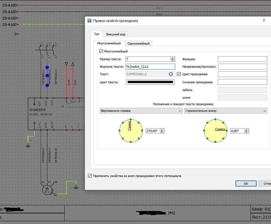

and whe paste...
on conductors f_text present
but on elements - isn't
pic2.png, 61.97 kb, 939 x 777

Try to uncheck Do not store the the label of the items in the copy paste
https://download.qelectrotech.org/qet/forum_img_2/ru_paste.png
Re: copy -> past elements like conductors
GREAT!!! TY  a LOT!
