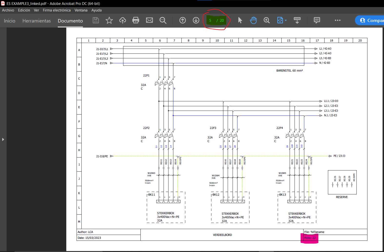

I have tested the tool
I changed the settings to comply to my pages format
the tool finds 99 links but only 4 links created
they are on page 50
but the links are not going to the correct page
so what is the trick to make it working?

Hi LivenC,
The program looks for the texts with the format you set in the configuration (reference format) and creates a link to the corresponding page and zone of the .pdf
Your file has 20 sheets, so it is impossible to create links on sheet 50 for example.
I understand that in an electrical diagram the number of the printing sheet does not have to correspond to the name of the page, but this is not currently supported by the program.
