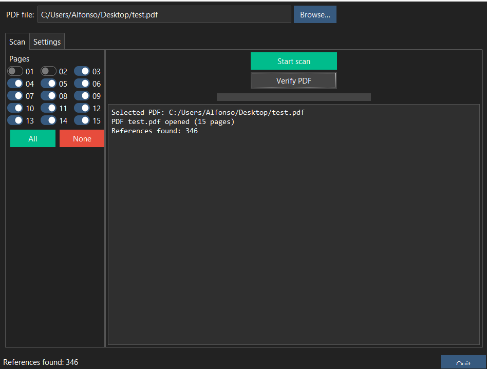

In the company where I work, Faramax, we have created (with the help of AI, because we are not code programmers), this program in Phyton to create links between references in a .pdf file
This is a stopgap while the integrated function in QET is being developed, which would be great. Wish we could help with this, but as I said we are not programmers.
We have based it on this, but I prefer to create a new topic so we don't mix up the posts: https://qelectrotech.org/forum/viewtopic.php?id=2915

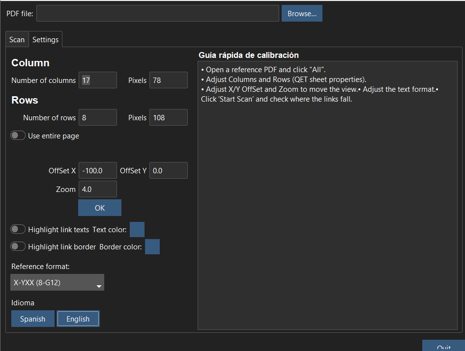

This program have calibration and adjustment options. It does not acquire the positions of the QET elements, but creates a virtual grid that must be adjusted with the row, column and px values that it adjusts in the QET sheets.
Alse, the program have additional offset settings for fine tuning.
When the program finds a relation to the selected structure, it creates a link to the target page and grid position, with the selected settings and zoom.
Attached you can find the programme in .py and in a ready for windows .exe inside the .rar
Hopefully this tool will be useful to many people, until QET integrates the function to include the links in the exported pdf.

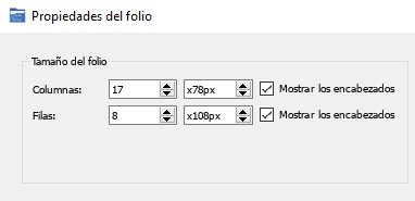

Hi LivenC,
The program looks for the texts with the format you set in the configuration (reference format) and creates a link to the corresponding page and zone of the .pdf
Your file has 20 sheets, so it is impossible to create links on sheet 50 for example.
I understand that in an electrical diagram the number of the printing sheet does not have to correspond to the name of the page, but this is not currently supported by the program.
