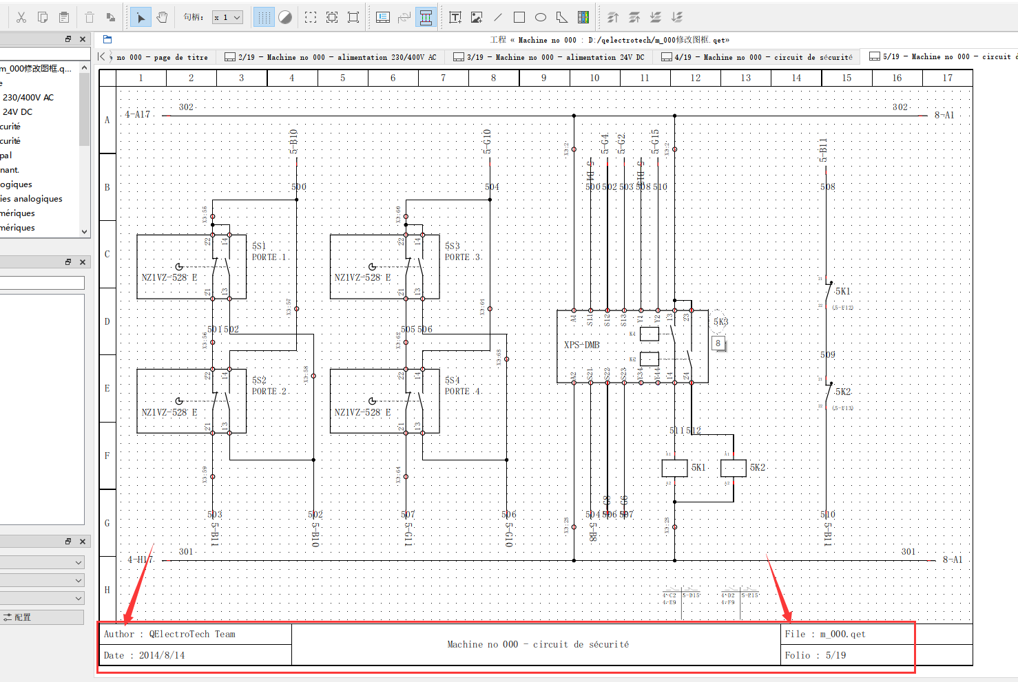

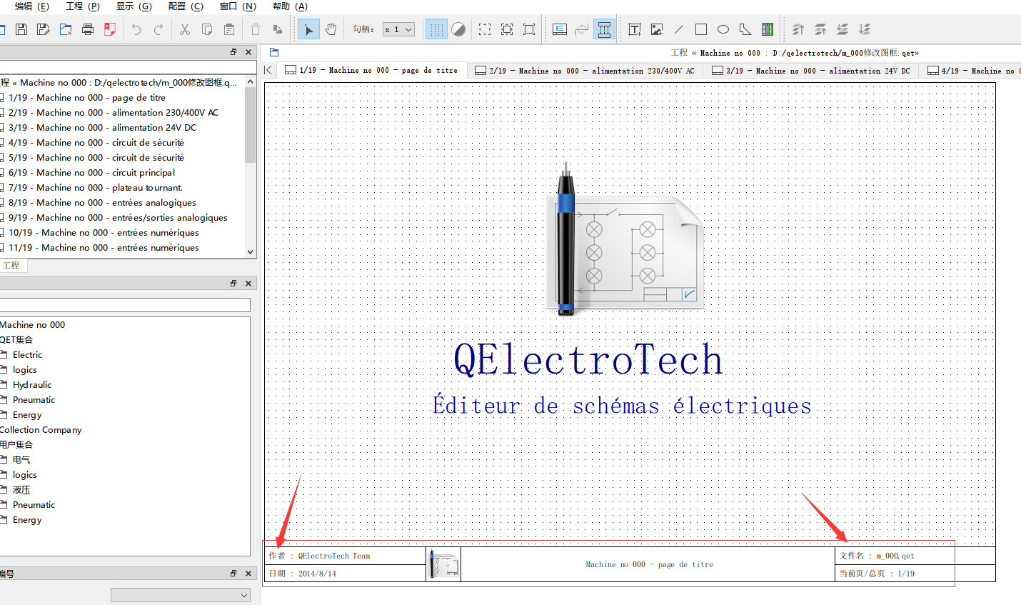

QQ截图20250424150823.png, 157.16 kb, 1430 x 847
QQ截图20250424150858.png, 132.81 kb, 1478 x 991
Re: missing Chinese translation (was: bug)
Why?
What is wrong?
I only see that you use different titleblocks.

I didn't look at the QET-Sources yet, where to find the position of missing language.
But as a workaround you can translate the missing texts in your template by hand...
5 (edited by plc-user 2025-04-27 11:50:38)
The translations for titleblocks have to be done in the same way as for elements:
The author of a titleblock has to take care of the translations...
According to your screenshots I translated the items of available titleblocks to Chinese and uploaded them to github-repository of QET.
They will therefore be available in next release of 0.100-dev - version of QElectroTech.
Addendum:
This is a great opportunity for you to contribute to QET-project:
As a native speaker you could proofread/correct the texts in the titleblocks...

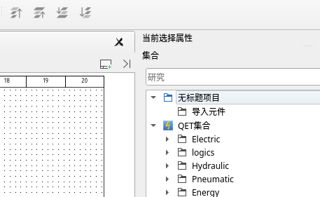

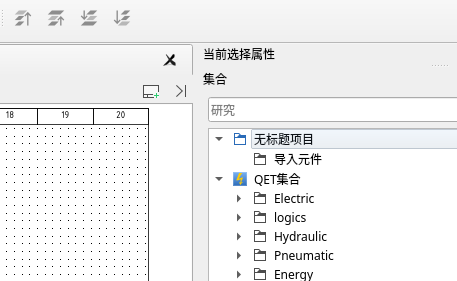

In the attachment you see screenshots with language set to Chinese.
There you can see translated terms in collection-tree and project-tree.
If you do not see them with version 0.100-dev, you did not start QET with the batch-file "Lancer QET.bat".
Bildschirmfoto_2025-05-04_collection-tree.png, 15.36 kb, 457 x 281

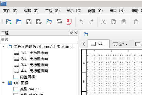

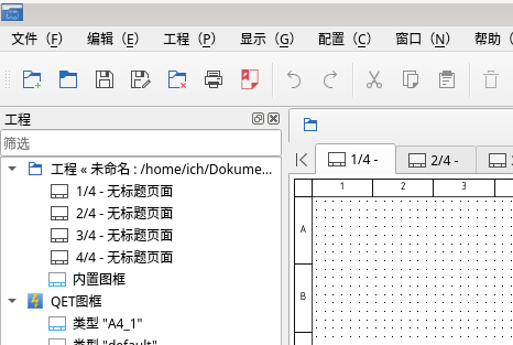

... project-tree
Bildschirmfoto_2025-05-04_project-tree.png, 23.43 kb, 466 x 313

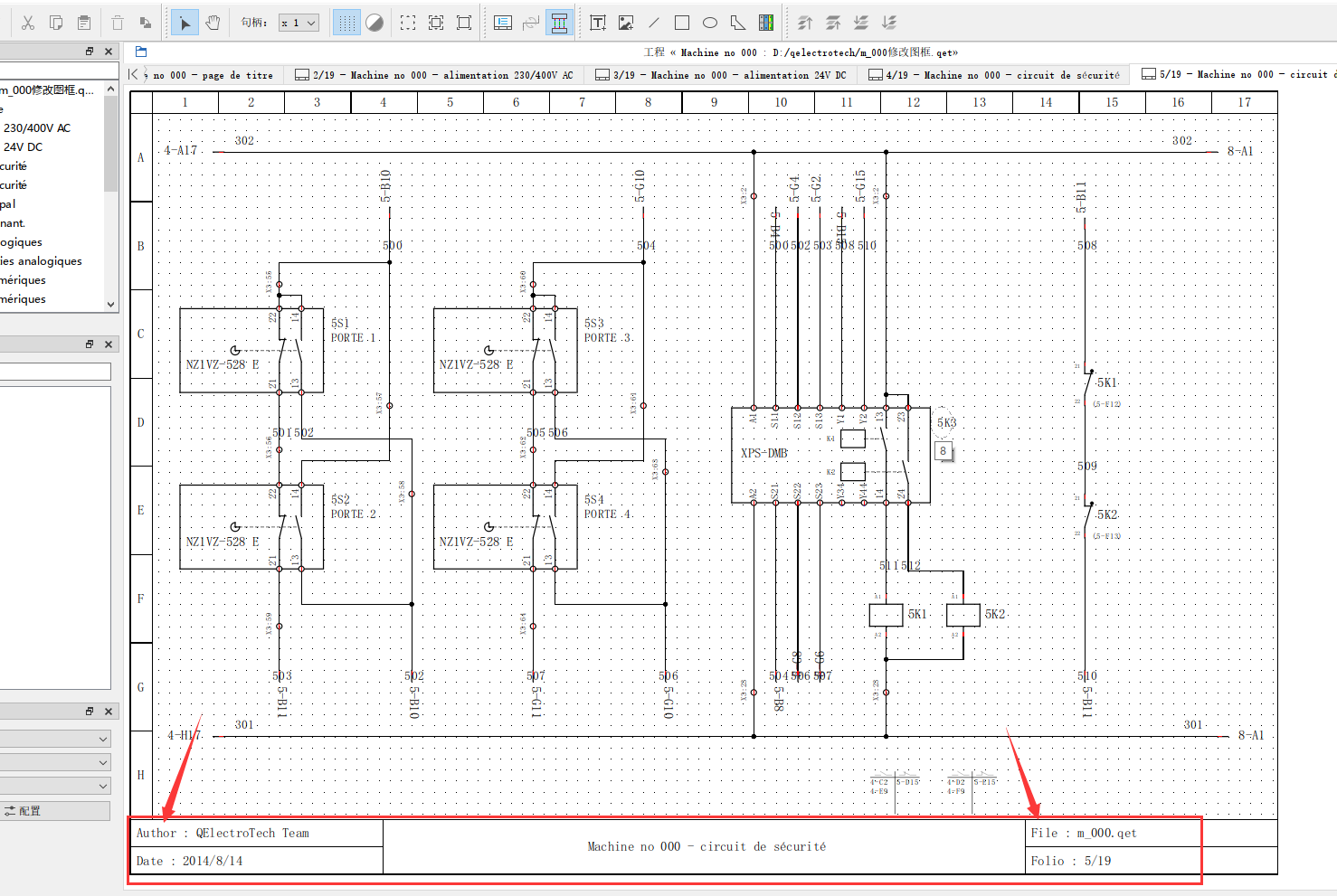

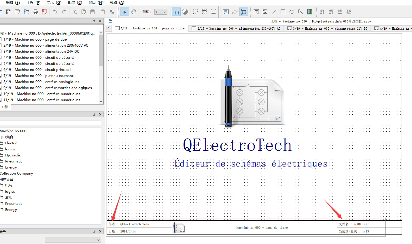

I'm posting a new video. What I want to say is that the new project frame is in Chinese. After saving, closing and then opening it again, it will become a Chinese frame that is not what I saved.
video
20 (edited by plc-user 2025-05-06 22:43:12)
We first had to get the basics, before coming to specific problems.
When I look at your video, it seems that the titleblock you edit is not the titleblock you use in the project!
As I wrote in a previous message: You edit one titleblock but use and look at another in the project.
This is an educated guess, because in the project-tree the titleblock-template has a pink background color!
That means, that this titleblock (or element in collection-tree) is not used in the project.
If you use
Project --> Clean project --> OK
Does the titleblock with the pink background in the project-tree disappear?
Edit:
If you want to use a customized titleblock, save it to a new filename to company- or user-collection of titleblocks and adjust setting in QElectroTech- and project-settings.
