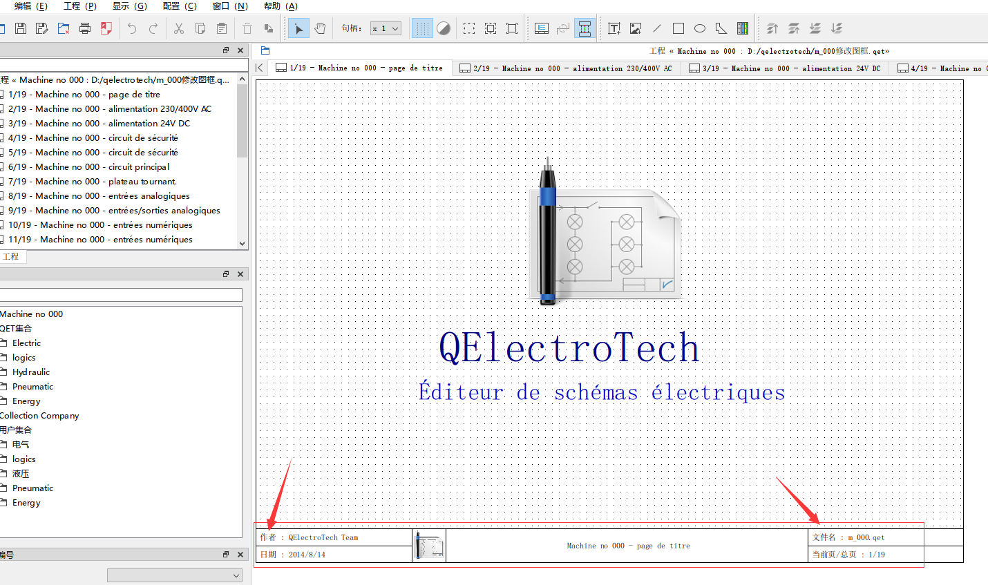

Sorry, I didn't express myself clearly. What I meant was that I changed the content in the drawing frame to Chinese, but some of the drawing frames are different from what I changed and still show the previous content.
Texts in titleblocks are missing for Chinese language!

To get the facts:
- You set the language inside of QET to Chinese.
- You use different titleblocks in one project.
- The titleblocks you use do not contain Chinese translations.
- You change the English translation in one titleblock.
- You expect changed texts in another titleblock?
All in all: The result cannot be correct!

When I look at your video, it seems that the titleblock you edit is not the titleblock you use in the project!
As I wrote in a previous message: You edit one titleblock but use and look at another in the project.
This is an educated guess, because in the project-tree the titleblock-template has a pink background color!
That means, that this titleblock (or element in collection-tree) is not used in the project.
