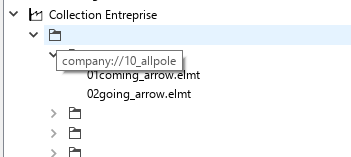

Cependant quand je rafraichis mes collections, les dossiers apparaissent bien, mais sans noms ni icones. je suis obligé de passer la souris dessus pour pouvoir voir le nom.
si je part d'un dossier vide et que je crée un dossier, le nom s'affiche bien. mais si je copie la structure de la collection qet, plus d'affichage. ( voir photo)

Re: organisation de la collection entreprise
Try the same thing in the user collection. It could be that this detail with qet_labels.xml does not work as planned with the company collection.
Or try using a local drive instead of a network drive for the company collection for a test...
It works when I use my local drive.
However, the goal of a company collection is to share it with everyone in my company.
Do you have a solution to fix this?
i found a solution.
The link to my drive was too long.
with a shortest link, i fix the problem.
thanks
