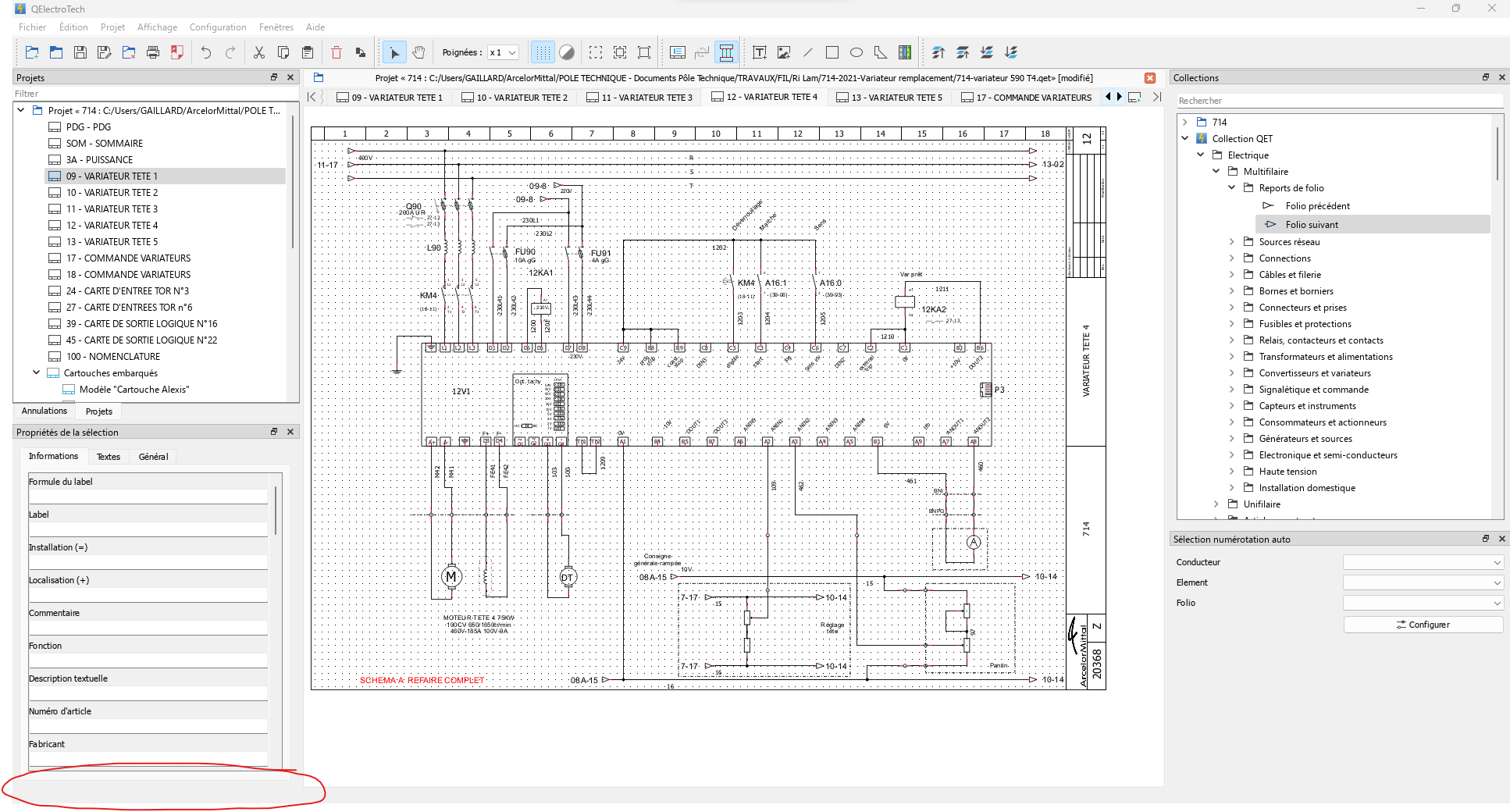

Re: Merci.ReadyToUse git8440 : déplacement libre texte dynamique
Merci.

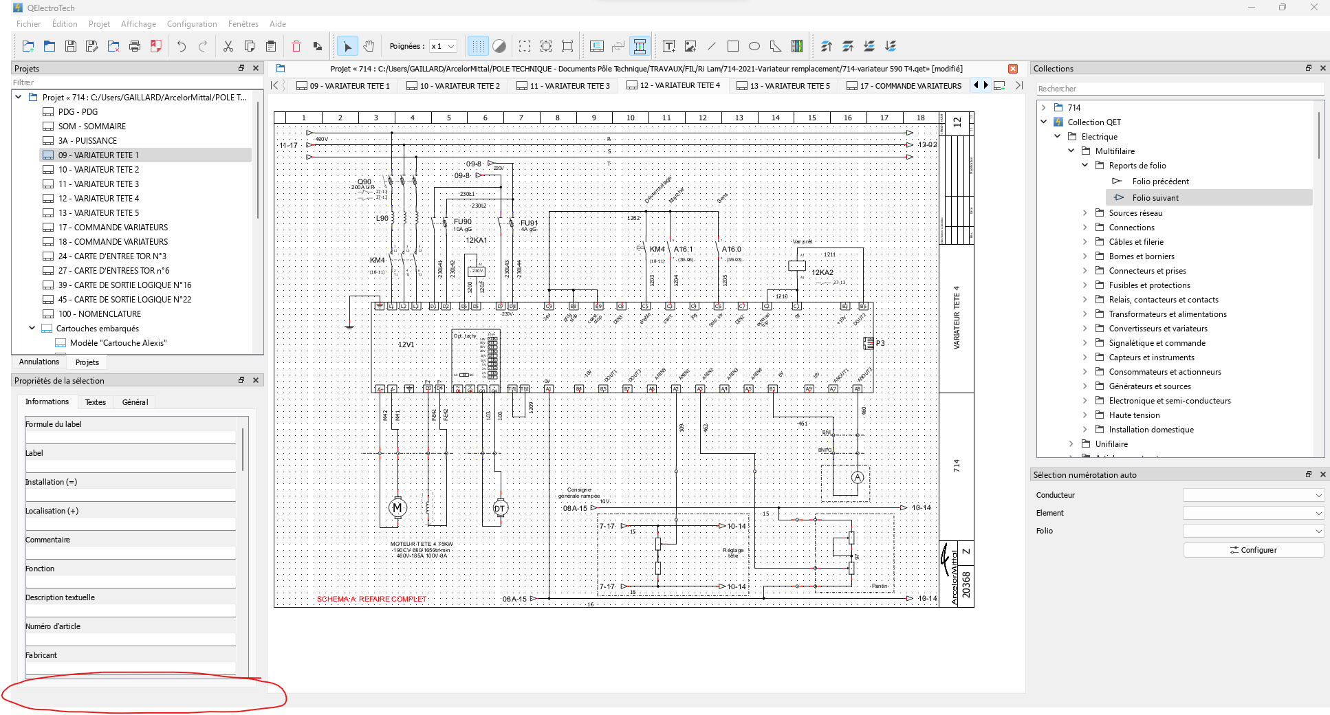

Est-ce possible d'ajouter un texte d'aide dans la barre du bas ?
Thank you very much.
It is possible to add help txt on back side bar ?
Attachment icon Capture d’écran 2025-04-04 083941.png 208.09 kb, 12 downloads since 2025-04-04

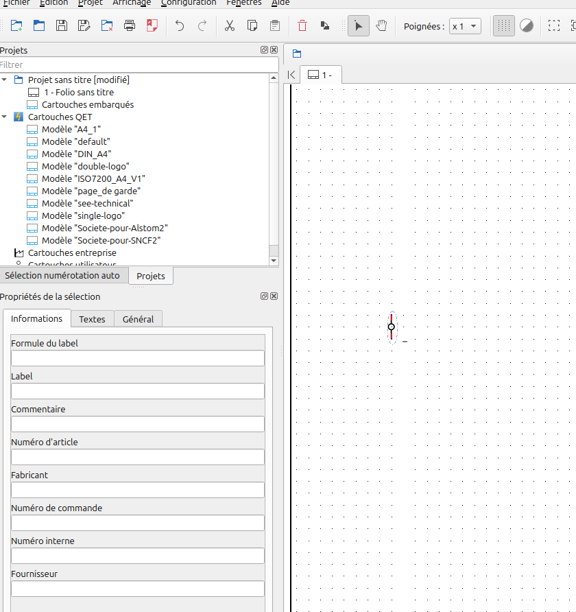

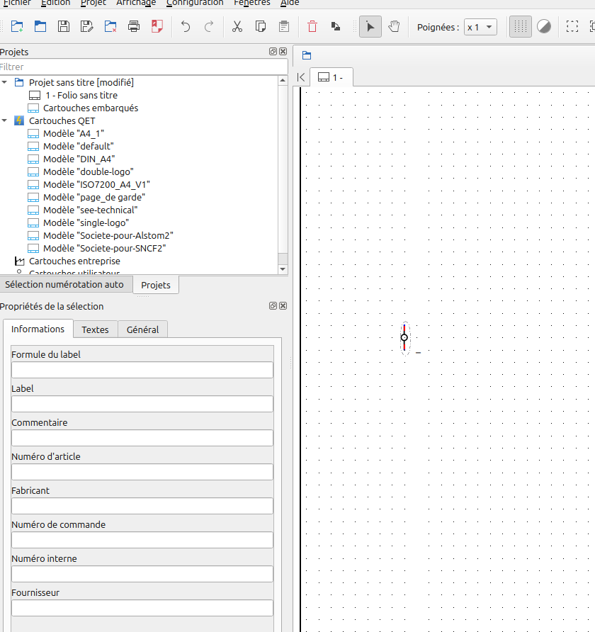

10
Yes, it's possible, but on this version. It's impossible to set properties like  machine, localisation
Attachment icon Capture d’écran du 2025-04-04 21-28-14.png 75.61 kb, 8 downloads since 2025-04-04

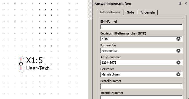

12
Can not confirm: Everything can be entered here to the edit-fields. See attachment.
It's the version from Package qelectrotech-0.100.0+git8440-x86-win64-readytouse.7z
QElectroTech V 0.100.0-dev
Compilation: GCC 13.3.0
Built with Qt 5.15.16 - x86_64 - Date : Mar 26 2025 : 12:21:06
Run with Qt 5.15.16 using 2 thread(s)
Attachment icon Bildschirmfoto_2025-04-04_Properties.png 21.33 kb, 14 downloads since 2025-04-04

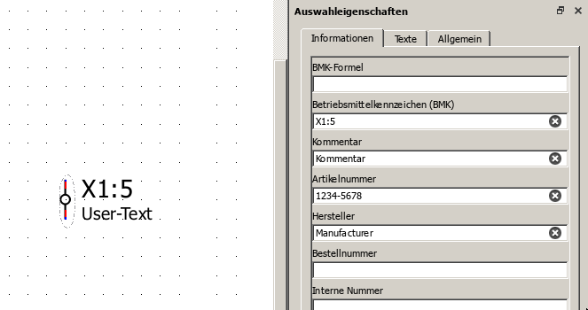

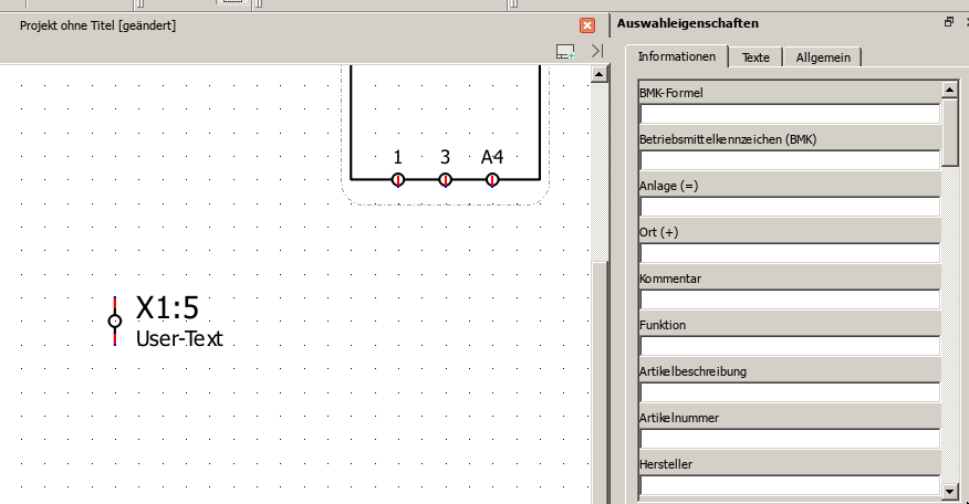

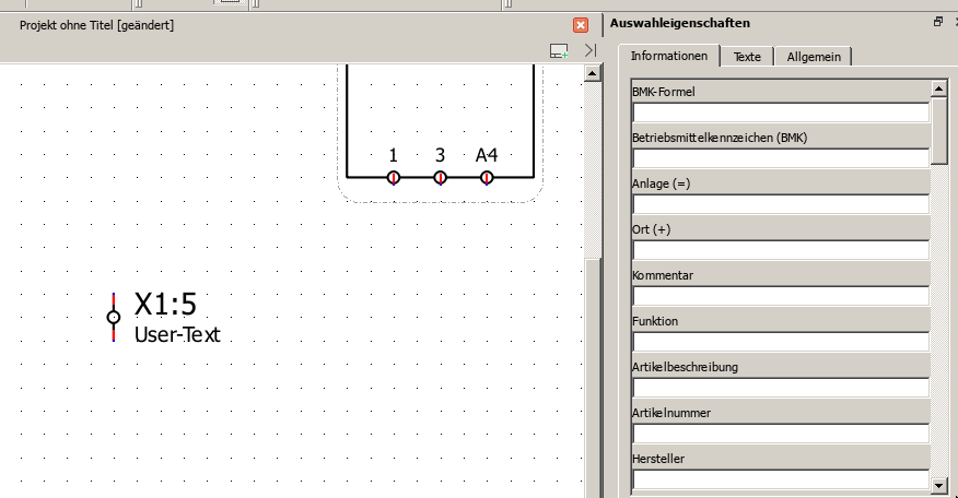

Now I guess I know what you mean:
For terminals no additional properties can be added in element-editor, so in diagram-editor these edit-fields are also not visible.
If you choose a "simple" element, all properties are available also in diagram-editor.
see attachment.
When I recall correctly, there was no change to that behavior recently...
Attachment icon Bildschirmfoto_2025-04-04_more_Properties.png 25.24 kb, 14 downloads since 2025-04-04
