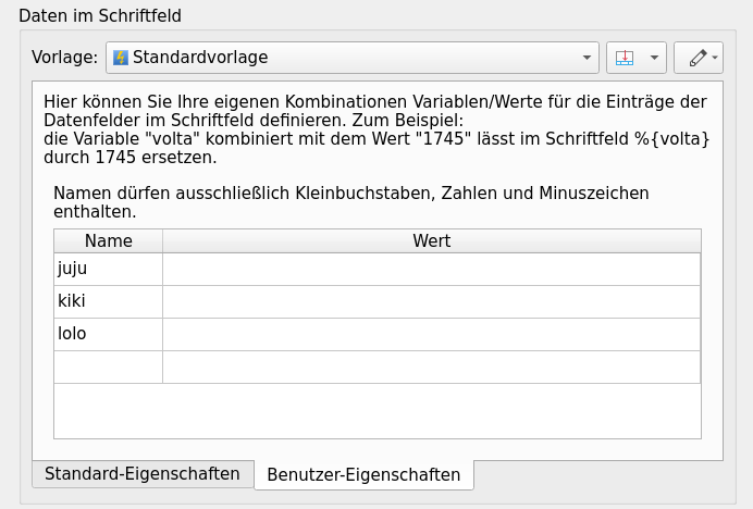

Did you read my posts?
especially this one: https://qelectrotech.org/forum/viewtopi … 021#p21021
When the problem exists, it exists in all current flavors of QET!
But as I wrote:
I think I found what you mean and can fix it with the patch in this post:
https://qelectrotech.org/forum/viewtopi … 024#p21024
In the meantime I created a project with empty properties, saved the file and re-opened it again – et voila: see attachment!
Empty properties are saved and reloaded!
Salut Galexis !
especially this one: https://qelectrotech.org/forum/viewtopi … 021#p21021When the problem exists, it exists in all current flavors of QET!
https://qelectrotech.org/forum/viewtopi … 024#p21024In the meantime I created a project with empty properties, saved the file and re-opened it again – et voila: see attachment!
It's should be perfect, like before.
Edited post!
