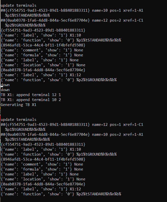

i made a deeper dive into the source of the plugin
Within the plugin i switched positions with the down button.
Attached is example file and backup from the plugin created. Source is from here https://github.com/raulroda/qet_tb_generator-plugin

The lower part lists the tree withing "def save_tb(self, filename)"
It looks as if the properties of the terminals are switched (ground and standart) and not, like i hoped the positions within the plugin.
