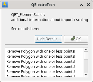

I also played with the possibilities to give more information to the user and learned, that a MessageBox can have three texts:
QMessageBox msgBox;
msgBox.setText("QET_ElementScaler: \nadditional information about import / scaling");
msgBox.setInformativeText("See details here:");
msgBox.setDetailedText(error_output);
msgBox.exec();
That results in this MessageBox (details are hidden by default):

Such an additional MessageBox should only popup, when there really is information for the user: When everything's fine there should be no additional Box to close...
This means that we should be very frugal with any outputs in our CLI software!
If there is nothing to report, then shut up!   nomicons/wink

@plc-user that multi-info messagebox looks like a useful way to do it. I agree the box should only popup when it's needed to provide info to a user, if everything goes well they should just get the element in the editor.
In verbose mode to print the element to stdout there shouldn't be a lot of information I think if everything goes well it's mostly just created <file_name>.elmt or something like that I would need to go double check. Clearly though something slipped through in my commit. The "Remove Polygon with one less points" was something I had in there when I was testing the most recent couple of commits, which doesn't convert single point polylines, and converts dual point polylines from Polygons to Line Elements. I thought I had removed them all from the code before commiting, but clearly missed something.
