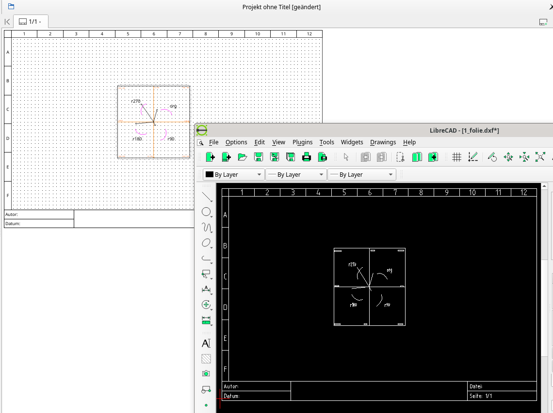

Tried with current version QET 0.10dev:
A dxf-file is created what LibreCAD can open and it looks quite o.k.

Re: Export DXF
@Andy: what your OS?
Edit: just tried on macOS with 0.100-dev and libreCad=DXF export OK..
Re: Export DXF
Hi. My OS is Win 11 Pro 64 bit. I have downloaded Librecad and it works perfectly. Thanks
