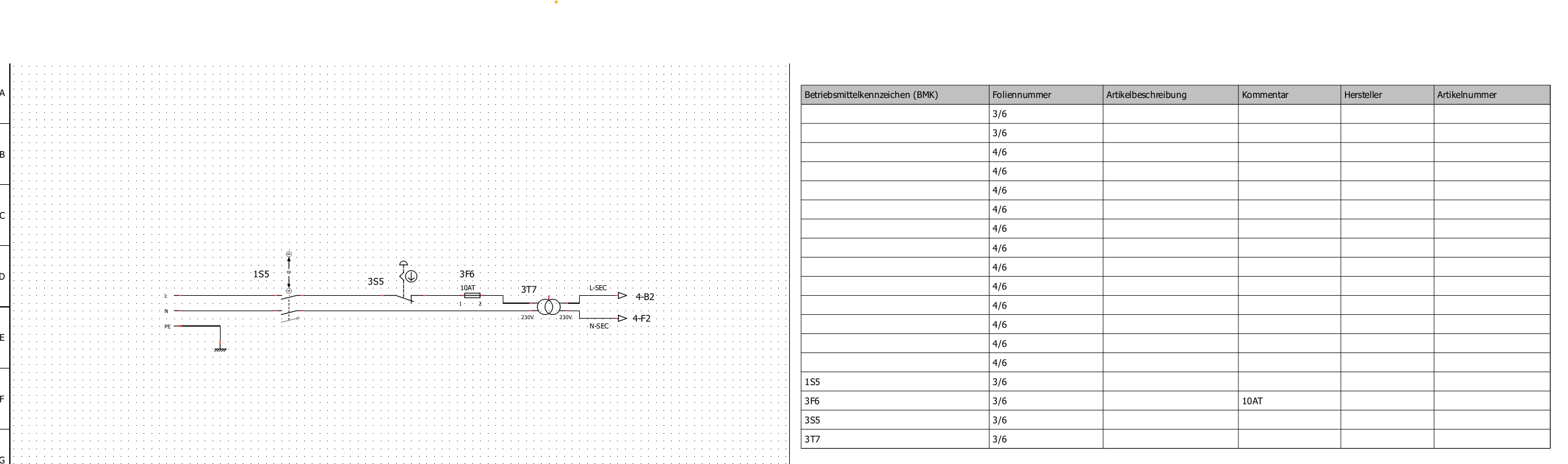

Hello all
I created a BOM as described here. It basically works but I am not able to exclude the page references.
You find the result attached. I don't want to have the page references in the BOM, but I am unable to define the right filter option to ignore them.
Does anybody have an idea?
Kind regards
Felix
qet-bom.png, 58.14 kb, 2545 x 753
Re: Unable to exclude page references from nomenclature/BOM
A BOM page must not contain any schemes..
https://qelectrotech.org/forum/viewtopi … 256#p16256
Yes, this allowed for showing the problem in one screenshot nomicons/wink
I haven't tried out the procedure in the thread yet. But if I understand correctly you have to build a query using the SQL browser. Once this query works, you can put it in qelectrotech and save the setup.
Thank you very much for the quick response.
Kind regards
Felix
I finally was able to try it out, this is exactly what I was looking for. Thanks!
