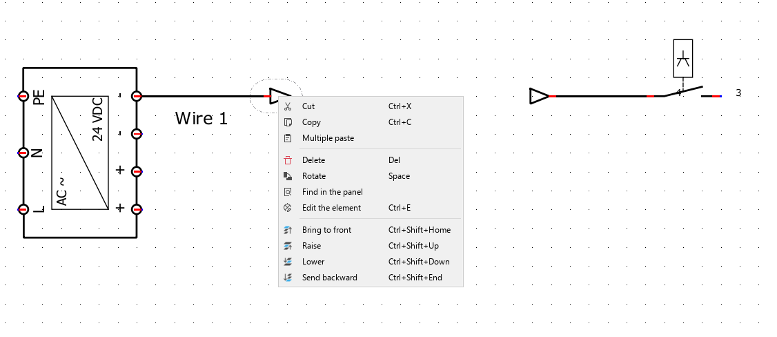

How to make a connection like the one in attached file (24V)?
I used comming arrow and going arrow elements, placed them in the schematic. They had "%{label} / %{tension-protocol}" text next to them which I changed to 24V. However I think I didn't make the connection.
Thanks for help

Hi Martin
For items like this they need to be linked. I have uploaded screenshots of the process.
Right click -> Edit Element -> Folio Referencing -> Right click and link item -> Apply -> Select which wire number you want to associate.
This is the same process for Master/Child elements.
You can then see the associations of items and they will stay updated with the referencing format if you move them around.
Hope this helps nomicons/smile
