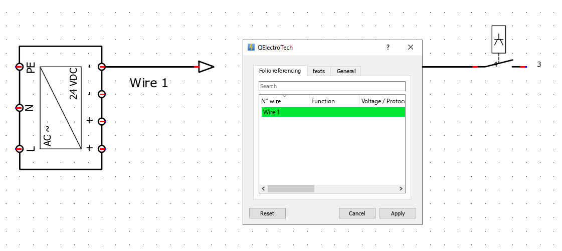

For items like this they need to be linked. I have uploaded screenshots of the process.
Right click -> Edit Element -> Folio Referencing -> Right click and link item -> Apply -> Select which wire number you want to associate.
This is the same process for Master/Child elements.
You can then see the associations of items and they will stay updated with the referencing format if you move them around.

Hi and thank you very much for your help and the detailed description.
5
Re: Indirect connection
I tried it and I think I can only connect 1 particular going arrow to 1 particular coming arrow. This definitely doesn't provide much flexibility for my design.
Imagine this: I have a power supply 24VDC and then I have many other elements that consume (are connected to) 24VDC. How do I connect all the elements with the power supply without drawing lines and thus making the schematic total chaos?
Also, I would like all the linked coming and going arrows to display some meaningful name of the wire (like 24VDC). How can I do that?
I'm sorry, I came from Altium/Eagle/KiCad PCB design software. It seems QElectroTech is very different and I have difficult times to achieve what I want.
