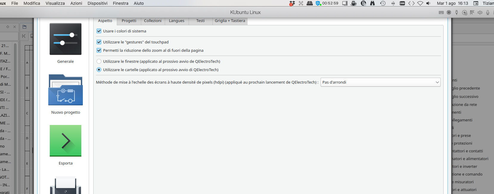

Re: Element selector 1NC+1NO or contact 1SC rear ref master-slave N°folio
Hello, Laurent (if I remember correctly this is your name..)
I'm sorry to bother you, but if you knew where to step in...
It is already like this and I had already posted it in the screens previously.
The settings are as you say and I've always used them like this, but the "%F" inserted in the setup does NOT take the label of the "Page" field, but always follows the position 1,2,3.. . whatever you enter in the "Page" field...
On the other hand, the references remain correct such as: the arrow, previous sheet, next sheet and coil contacts.
Attachment icon Schermata 2023-08-01 alle 15.55.45.png 294.53 kb, 57 downloads since 2023-08-01
Attachment icon Schermata 2023-08-01 alle 16.12.53.png 296.94 kb, 51 downloads since 2023-08-01
Attachment icon Schermata 2023-08-01 alle 16.13.15.png 239.83 kb, 60 downloads since 2023-08-01
Attachment icon Schermata 2023-08-01 alle 16.14.09.png 292.63 kb, 57 downloads since 2023-08-01
