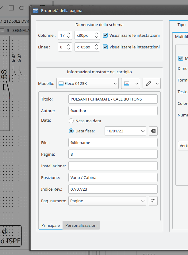

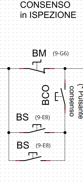

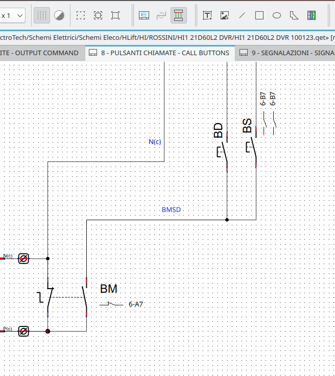

Hi everyone,
I realized that in some diagrams developed some time ago I had wrong references (sheet) but only some (selector) and contacts 1 exchange...
As shown in the screenshots...slave contact takes the sheet number (9-G96) which is actually 8.
The master does the same by placing 6-A7 which is instead sheet 5...
Why?
The oddity is that everything else is correct! coil-contact, previous sheet-next sheet...
Thanks

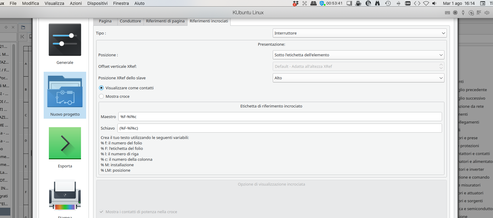

Re: Element selector 1NC+1NO or contact 1SC rear ref master-slave N°folio

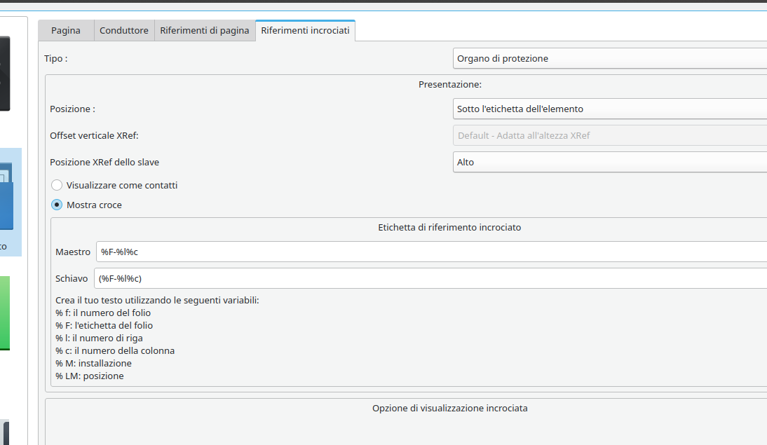

Hello Tiz,
check your formula use well %F in switch/button Cross Reference.

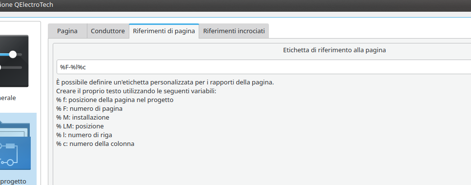

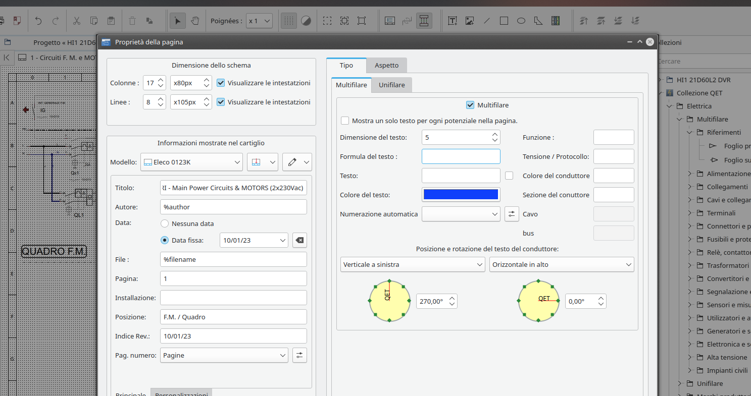

The problem is in the %F flag not setting the sheet label, which could also be non-numeric as it could be in a supplementary sheet "appendix" explaining "a detail" of the previous sheet such as a cad drawing or PDF attachment. ..
The thing is, %f and %F can't find any substantial differences.
%F should take the label set in setup and not the position..
To explain better, watch the video...
If I move the sheet which for convenience I have called "0" but could also simply be "INDEX", which describes the type of project with description, logo, characteristics... everything realigns itself...
This indicates that %F does not follow what is set in "Page" of the setup but always follows the position in the project.

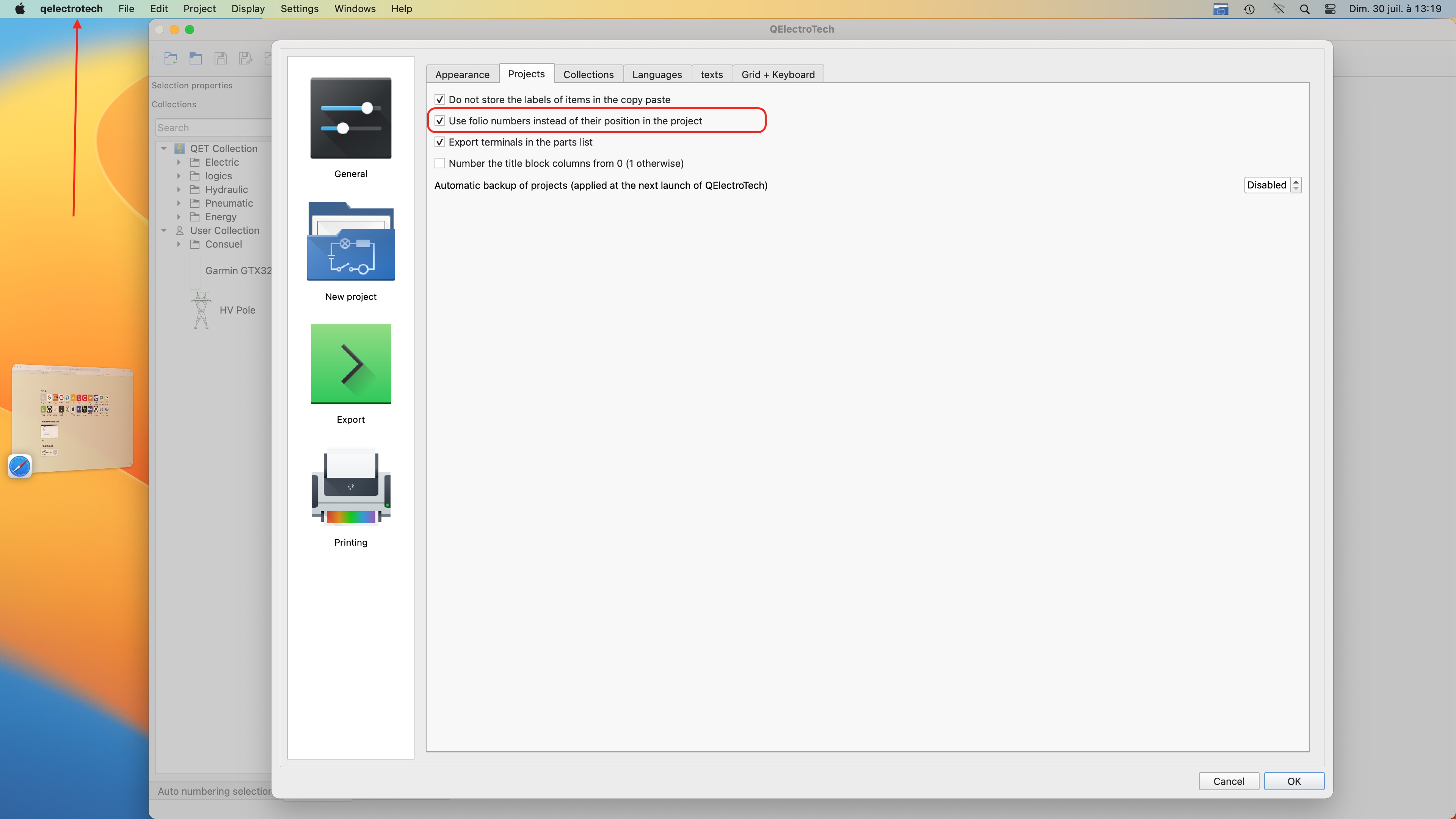

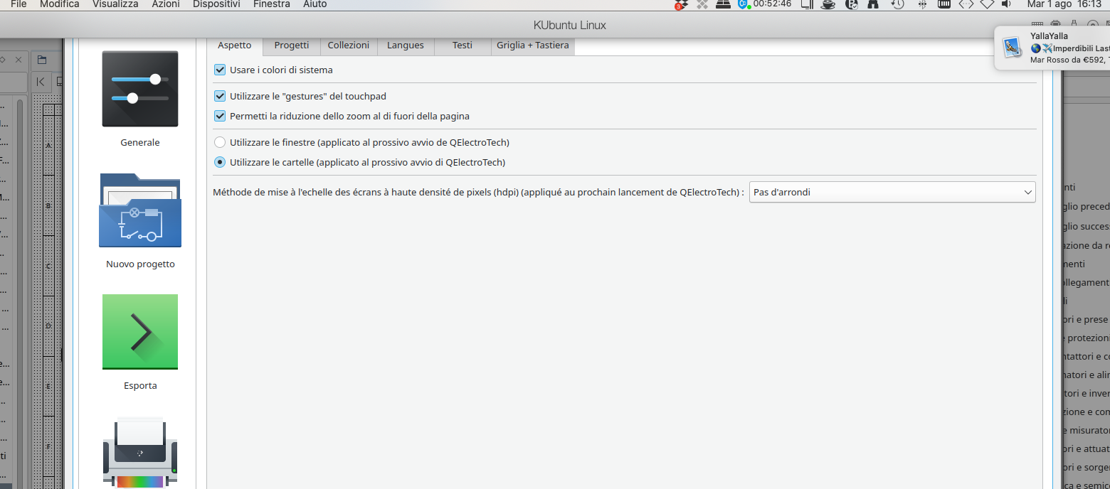

Hi, see picture..
Hello, Laurent (if I remember correctly this is your name..)
I'm sorry to bother you, but if you knew where to step in...
It is already like this and I had already posted it in the screens previously.
The settings are as you say and I've always used them like this, but the "%F" inserted in the setup does NOT take the label of the "Page" field, but always follows the position 1,2,3.. . whatever you enter in the "Page" field...
On the other hand, the references remain correct such as: the arrow, previous sheet, next sheet and coil contacts.
