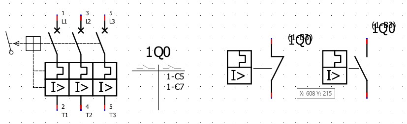

Please, I´m using a Magneto Thermal Circuit Break and one NF and one NO auxiliary contact.
Honewever, when I do the Cross Refecerence (Link to the item), it´s show me two NF contacts. How I may correct it?
Second point.
I edited the label of the Circuit Break, and the texts of auxiliary contacts get wrong.

About the wrong Xref (NC instead of NO) check the properties of the NO contact, the parameter of slave type is probably set to NC change it to NO in the element editor.

Strange, I think you use a very old QET version?

Hi I did a new download... Now I´m using V0.100.0-DEV.
I didn´t test yet, I will try.
