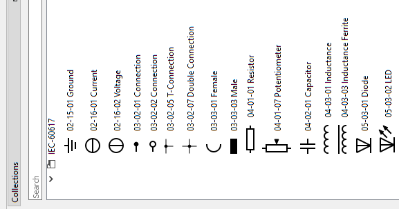

Re: Symbols IEC 60617 line width
Attached is a screenshot from my current IEC 60617 collection.
The naming with official IEC numbers is quite helpful
in order to find, sort and identify the right elements.
Regards from Rudy

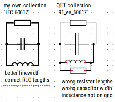

However the too small line width of the symbols is only a cosmetic issue.
A real issue is, that some very basic shapes (R, L, C) and a lot of more are not correct.
Sorry for that criticism. Here some examples:
  • The resistor R is too long (3/5 instead of 4 units)
  • The capacitor C is to wide (4 instead of 2 units)
  • The inductance L is not on the grid
The odd length (5) of the resistor R has the result, that you
cannot place a capacitor as usual parallel to a resistor.
An oscillator circuit with RLC should be realized good and easy.
-> see attached screenshot.
I like QET, because I will create my own symbols.
But I think, that the default IEC 60617 library can be improved.
It is also a good idea to make a compromise between
conductors, terminals, length, width and grid of symbols.
E.g. the inductance with length 4 does not need connection
conductors, but the capacitor and resistor with odd length
do need appropriate connection conductors.
Regards from Rudy

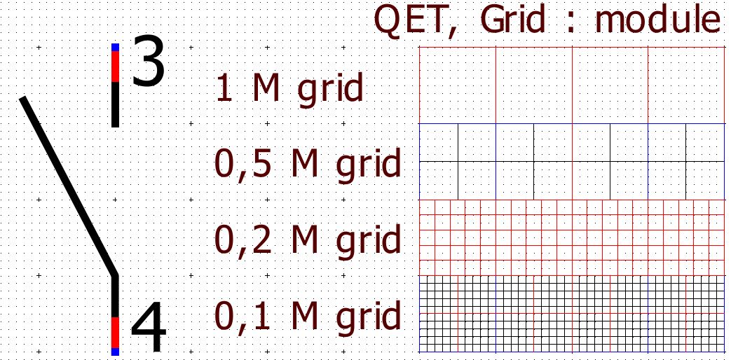

I have sometimes made auxiliary tools that I share with you. My drawing with the QET program has remained an exercise and a test to tinker with. I used to use programs that save in DWG format to update and change images.
I haven't found any discussion about Eleme's editor's grip M sizing. I documented it, grip M is 10xviiva 0.25 thick, grid 2,5.
Best regards, Pai

Hey,
QET line weight 0.35 drawing.
With the drawing handle set to 2.5 pages, the line strengths of the QET element drawing program are 0.125, 0.25, 0.50, 1.25.
By setting the drawing handle 2 to the side, the line strengths change by a factor of 0.8.
Foil properties, appearance size: 1.4, corresponds to size 0.35.
A line weight of 0.35 can be drawn by drawing three 0.125 "thin" lines according to the attached model.
Regards, Pai54
