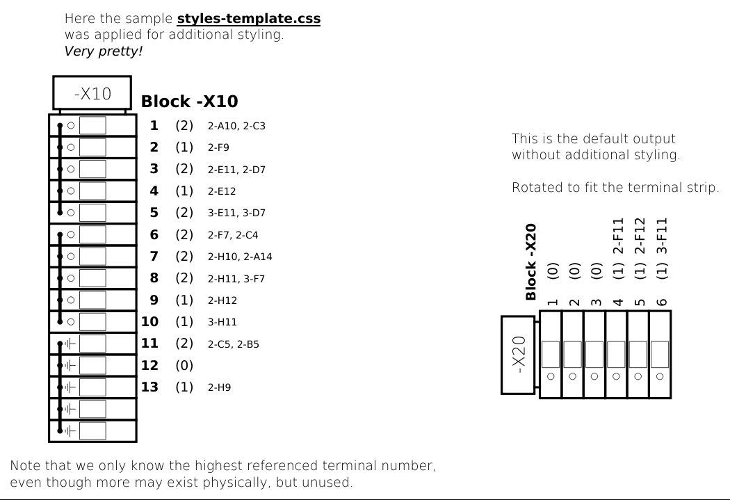

Hereby I introduce my little open source project "HTML Table Generator From QElectroTech Terminal Elements", or qet_terminal_tables for short.
It works by reading the SQLite database exported from the QET project, then outputting HTML code to a separate file for each block of terminals.  The elements must be labeled with a colon separating the block name from the terminal number (which should be an integer).  The HTML code can then be copied into the Source tab of an HTML-styled text field in the original QET project.  This can be placed next to a drawing of the terminal strip as desired, which ideally has a 20 pixel grid.  Styling is rather limited because of the HTML subset supported by Qt, but a CSS file can be referenced to customize the appearance.
The Python code and docs can be found on GitHub at https://github.com/acolomb/qet_terminal_tables together with a sample project.  Attached is a screenshot.
I tried to keep the code clean and maintainable, but it's not yet properly packaged with versioned releases.  Help with building a proper Python package is very welcome, as are other suggestions and contributions.
Have fun with it and tell me your experiences :-)
1_terminal_strip_diagram.png, 88.91 kb, 1050 x 719

That looks pretty cool indeed, thanks for pointing it out. I'm eager to try it out in the next released version.
Until then, I need a stable solution though, based on software that I can point a customer to - no development version which is a moving target and things might just stop working at some point because they were generated with an intermediate development snapshot. Sorry I can't get much more involved with QET development, but rather just consume the stable version releases as they come. What a great software by the way, thanks to all the people making this a reality as FOSS!
Publishing my own little addition as FOSS is my way to give back to the community for being able to use a completely free CAE drawing software.
Re: New tool to generate terminal strip diagrams - text only
Compared to the existing plugin, as I tried to explain, my tool simply collapses all terminals with the same label into one row, whereas qet_tb_generator will duplicate the terminals (see repeated numbers in your screenshot).
And it doesn't insert "missing" terminals in between (number gaps), which we often have when leaving some spare room for connecting later additions.
What both tools cannot do is guess how many more spare / unused terminals there are beyond the highest number found.  That's why I went for drawing the block manually and only generating the labels.  This issue is similar to the "fill in the gaps" feature above, but cannot be solved as easily.
As a final point, we often use terminals with e.g. 4 connection points to distribute the same potential (usually GND, 24 V).  The existing plugin AFAIK only generates one terminal "slot" per reference, you can't tell it that the elements -X10:1a and -X10:1b are actually on the same terminal.  We just put this info into the elements' extra text field, separate from the label.  The terminal strip diagram then just lists the refs in no particular order, but where it's defined in the schematic, you always see which connection point was used (a, b, c, or d).
I hope the future QET-integrated version will address these points (multiple mentions of same terminal; spare terminals in between; spare terminals at the end; more than two connection points). Then it will be suitable for my use-case.
