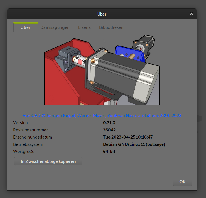

Deluxe example FreeCAD:
there is a button
Copy to clipboard
which adds "code"-tags, there can everyone easily post to the forum or open a new issue and add all important information (not all visible in the version menu directly) for the developer/helper in a short way.
OS: Debian GNU/Linux 11 (bullseye) (GNOME/gnome-xorg)
Word size of FreeCAD: 64-bit
Version: 0.21.0.26042
Build type: Release
Python 3.9.2, Qt 5.15.2, Coin 4.0.0, Vtk 9.0.1, OCC 7.5.1
Locale: German/Germany (de_DE)
Installed mods:
  * DynamicData 2.46.0
  * A2plus 0.4.60k
  * ThreadProfile 1.85.0
  * freecad.gears 1.0.0
  * dodo 1.0.0
  * toSketch 1.0.1
  * Curves 0.6.8
  * Assembly4 0.50.1
  * Manipulator 1.5.0
  * parts_library
  * lattice2 1.0.0
  * sheetmetal 0.2.63
  * LCInterlocking
  * BIM 2021.12.0
  * Silk 0.1.3
  * kicadStepUpMod 10.18.8
  * fasteners 0.4.56
salute Max
