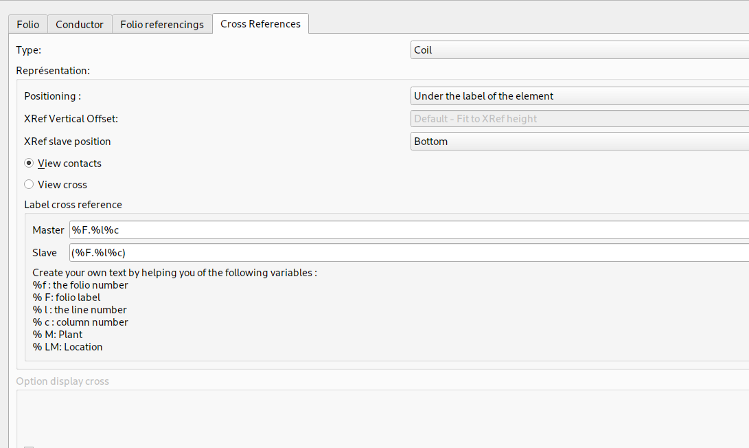

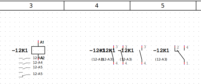

Hello,
is it only my problem with crossreference from "view contacts" like in picture?
With "view cross" work like a charm, but there not a symbol for changeover contact.

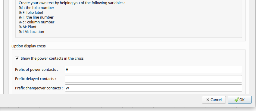

Changeover contacts are shown as openers and closers in the cross view. In the menu project project properties new slide cross references you can specify a letter for changing contacts.

Hey folks,
If you ask about "other slave" these symbol is only visible on list mode not in view cross.
Please more explain your problem, I don't understand what you want to say.
When i choose the radio button "view cross", the table is in center under the label, radio button "view contacts"(list mode) the contacts are shown all on the right side under the label.
Yeah thats right, but you don't see that is a change over. You see only a NC and a NO contact with the same position, but that can also two different contacts. I add two pics, then you see what i mean (change over contacts table and list).

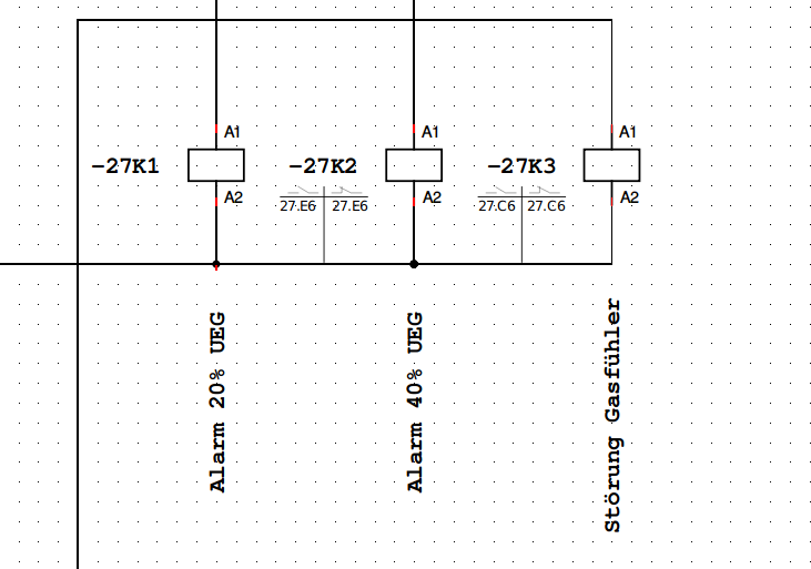

Max you want that:

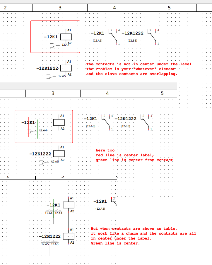

Hello,
@galexis
no i don't want this, but it would be nice for future.
@all
Sorry for confusion. I had thought it was clearly explained with the headline.
Now all in one picture and i hope that i make no more confusion.
Problem has nothing to do with change over contacts.
You can't switch to "contacts table" when you use change over contacts, they are not displayed correctly, what might be in the future.

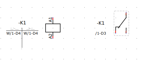

Strange, see:
https://qelectrotech.org/forum/viewtopi … 586#p16586
https://qelectrotech.org/forum/viewtopi … 596#p16596
https://git.tuxfamily.org/qet/qet.git/c … e0f67ef859
Re: Crossreference contact at coil sideways under label
https://download.qelectrotech.org/qet/forum_img_2/bunding_adjust_xref.png
Fixed: changeover contact causes a shift to the right of the presentation of all the contacts which are in list mode with respect to the master label.
https://git.tuxfamily.org/qet/qet.git/c … 0568a7ecc9
Please try qelectrotech-0.100.0-r7849 packages.
Enjoy! nomicons/wink

Hello scropio,
you are on the right way.
Thank you.

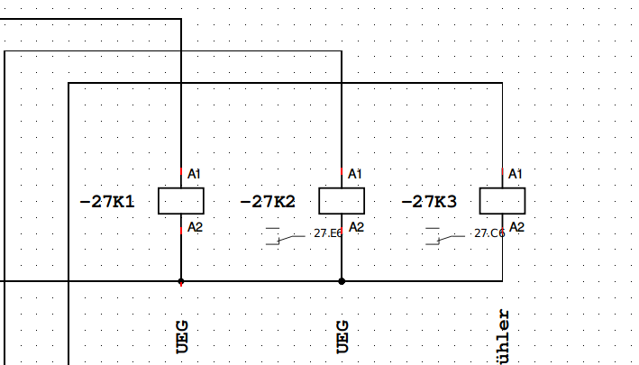

But i think it is not the best solution with fix dimensions. The labels have a alignment field, is there a way that the crossreference in a line with these?
