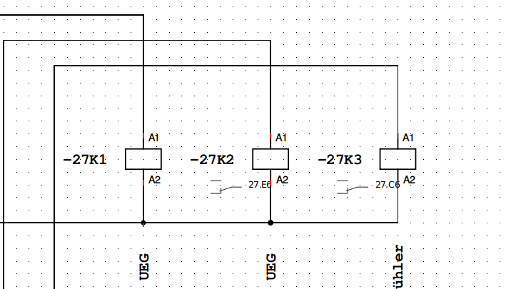

Hello,
is it only my problem with crossreference from "view contacts" like in picture?
With "view cross" work like a charm, but there not a symbol for changeover contact.

Re: Crossreference contact at coil sideways under label
If you ask about "other slave" these symbol is only visible on list mode not in view cross.
Please more explain your problem, I don't understand what you want to say.

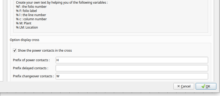

Hi Max,
Changeover contacts are shown as openers and closers in the cross view. In the menu project project properties new slide cross references you can specify a letter for changing contacts.
Hey folks,
When i choose the radio button "view cross", the table is in center under the label, radio button "view contacts"(list mode) the contacts are shown all on the right side under the label.
Yeah thats right, but you don't see that is a change over. You see only a NC and a NO contact with the same position, but that can also two different contacts. I add two pics, then you see what i mean (change over contacts table and list).
Max wrote:
Now the forum think im a bot, , i can't upload any pictures since this post.
Please try it again.
Hello Erik,
i change dot to minus, but still same problem.
Bildschirmfoto von 2023-04-26 16-13-26.png, 17.02 kb, 819 x 343
Hello MAX,
The left contact is too close to second contact, move this contact.
You can move the texts.
You can also move the text at the coil.
Erik
Hello,
@galexis
no i don't want this, but it would be nice for future.
@all
Sorry for confusion. I had thought it was clearly explained with the headline.
Now all in one picture and i hope that i make no more confusion.
Problem has nothing to do with change over contacts.
You can't switch to "contacts table" when you use change over contacts, they are not displayed correctly, what might be in the future.
Zeichnung.png, 70.99 kb, 724 x 905
