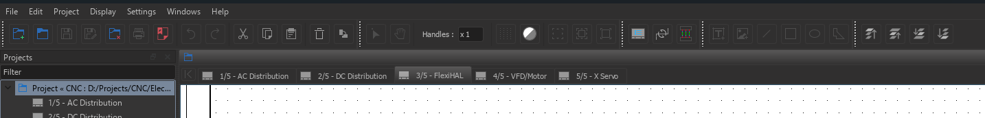

Thank you. I have a dark theme now, however the contrast on the icons is very poor. Is there any way to adjust these icons?
Maybe https://doc.qt.io/qt-6/stylesheet-examp … g-qmenubar
Hmm, no luck with that one, managed to change the font colour, and the background of the buttons under QToolButton. But no luck on the actual icons. Appreciate the help though.
The icons are just images and were designed for the white theme, the only thing you can try is to change the menu bar background to gray.
We don't have any icons for the black theme, nor does QET have any code to detect the theme change and select the correct icons...
