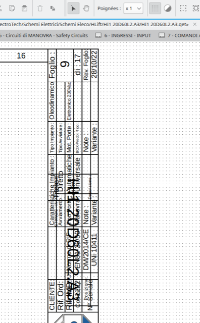

Hello,
What can cause the orientation of certain names to be incorrect when setting the title block of the page from horizontal to vertical? (%title, %projecttitle...)?

Re: Error repository
You could share this title block?
For tag
Resolved.
The texts in the variable cells, during the rotation, being the shorter side, did not enter inside.
He'll use a vertical page with proportionate cartouche for these purposes (layout, instructions) etc...
