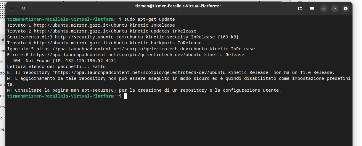

Topic: Error repository
sudo apt-get update
Update
error repository:
"E: The repository "https://ppa.launchpadcontent.net/scorpio/qelectrotech-dev/ubuntu kinetic Release" does not have a Release file."
"N: Updating from this repository cannot be done securely and is therefore disabled by default."
Schermata 2023-01-02 alle 16.26.12.png, 98.56 kb, 1223 x 494

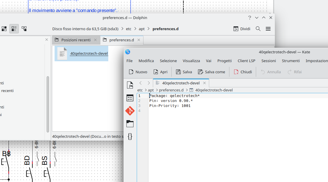

Re: Error repository
setup as instructed on QE:
Schermata 2023-01-02 alle 18.42.15.png, 110.33 kb, 1118 x 621
Upgrade off pinning :
sudo sed -i 's/'"version 0.90.*"'/'"version 0.100.*"'/' /etc/apt/preferences.d/40qelectrotech-devel
Edit: I'm adding Ubuntu Kinetic for future packages.
Accepted:
OK: qelectrotech_0.100.r7778.orig.tar.gz
OK: qelectrotech_0.100.r7778-2ubuntu4.debian.tar.xz
OK: qelectrotech_0.100.r7778-2ubuntu4.dsc
     -> Component: main Section: electronics
qelectrotech (0.100.r7778-2ubuntu4) kinetic; urgency=medium
  * Kinetic Upload to ppa

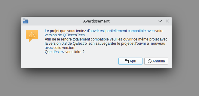

Hi, Laurent
with new AppImage: QElectroTech_0.10-DEV-r7778-x86_64.AppImage
when he opens the file that I had previously worked on and saved with dev 0.9 he always generates this message:
I opened it and overwrote it but it keeps reporting it.
Schermata 2023-01-13 alle 03.51.30.png, 44.87 kb, 662 x 320
Hi Tiz,
please try new packages, I added more informations:
https://git.tuxfamily.org/qet/qet.git/c … f49ee5f4af
Fix translations:
https://git.tuxfamily.org/qet/qet.git/c … 1ac94046e4
https://download.qelectrotech.org/qet/forum_img_2/warningBox2001.png
https://download.qelectrotech.org/qet/forum_img_2/warningBox1001.png
Get 0.8 AppImage.
wget https://download.qelectrotech.org/qet/builds/AppImage/QElectroTech_0.8-r7124-x86_64.AppImage
And try to save your project with this 0.8 and re open with latest 0.100 appimage.
wget https://download.qelectrotech.org/qet/builds/AppImage/QElectroTech_0.10-DEV-r7784-x86_64.AppImage
Make a backup of your project before.!
BTW, if you have created your project with 0.8, 0.9 versions you can open your project, if is a example provided by us, yes some was old and need to be converted with 0.8 version.
Joshua can talk about it better.
Edit : Maybe is also this problem .. -> https://www.quora.com/What-is-greater-0-3-or-0-30
when we changed version 0.90 to 0.100
We want to fix with QVersionNumber see: https://www.ics.com/blog/whats-new-qt-5 … sionnumber
https://git.tuxfamily.org/qet/qet.git/c … 246c8e24c7
While it is supported by QVersionNumber, it is rare for software to use more than three levels of numbering. For convenience, the first three segments are referred to as major, minor and micro respectively.
https://doc.qt.io/qt-6/qversionnumber.html
hi,
OK done.
I open with 0.8.
I saved it by renaming it.
So I opened it on .10 and he didn't give me the signal.
Thank you.
Fixed by  Remi:
https://github.com/qelectrotech/qelectr … r/pull/244
