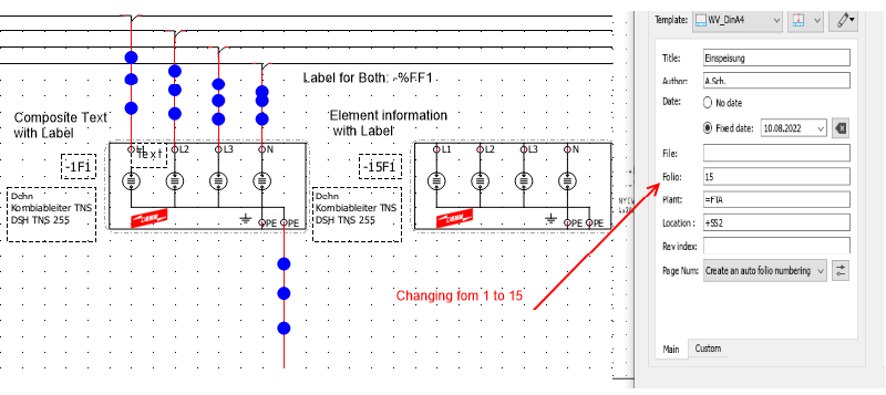

I think I have found two mistakes.
1.  I cannot delete folders in Usercollection.
     A Massage appears: "Folder deletion failed"
2. A label in a Composite Text is not been updateted.
    See picture for mor details.
  I use the latest windows version (installer and ReadyToUse 64bit)

2) See attachment
Re: Two mistakes?
Hmm don't use %F with composite text, folio label isn't in accessible variable for composite text.
BTW, a workaround is to cut this element and paste again when you have changed folio label. Or save, close and re open project.

Thanks Achim for report this issue.
Yes isn't refreshed on the fly.
