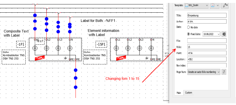

2. A label in a Composite Text is not been updateted.
    See picture for mor details.
  I use the latest windows version (installer and ReadyToUse 64bit)

Re: Two mistakes?
1) same things with 32 bits version?
Are you sure your directory isn't in read only mode?
2) maybe send your project for we try.

2) See attachment
Re: Two mistakes?
Hmm don't use %F with composite text, folio label isn't in accessible variable for composite text.
BTW, a workaround is to cut this element and paste again when you have changed folio label. Or save, close and re open project.

Re: Two mistakes?
Uhuhu. nomicons/smiley-green
Thanks Achim for report this issue.
Yes isn't refreshed on the fly.
