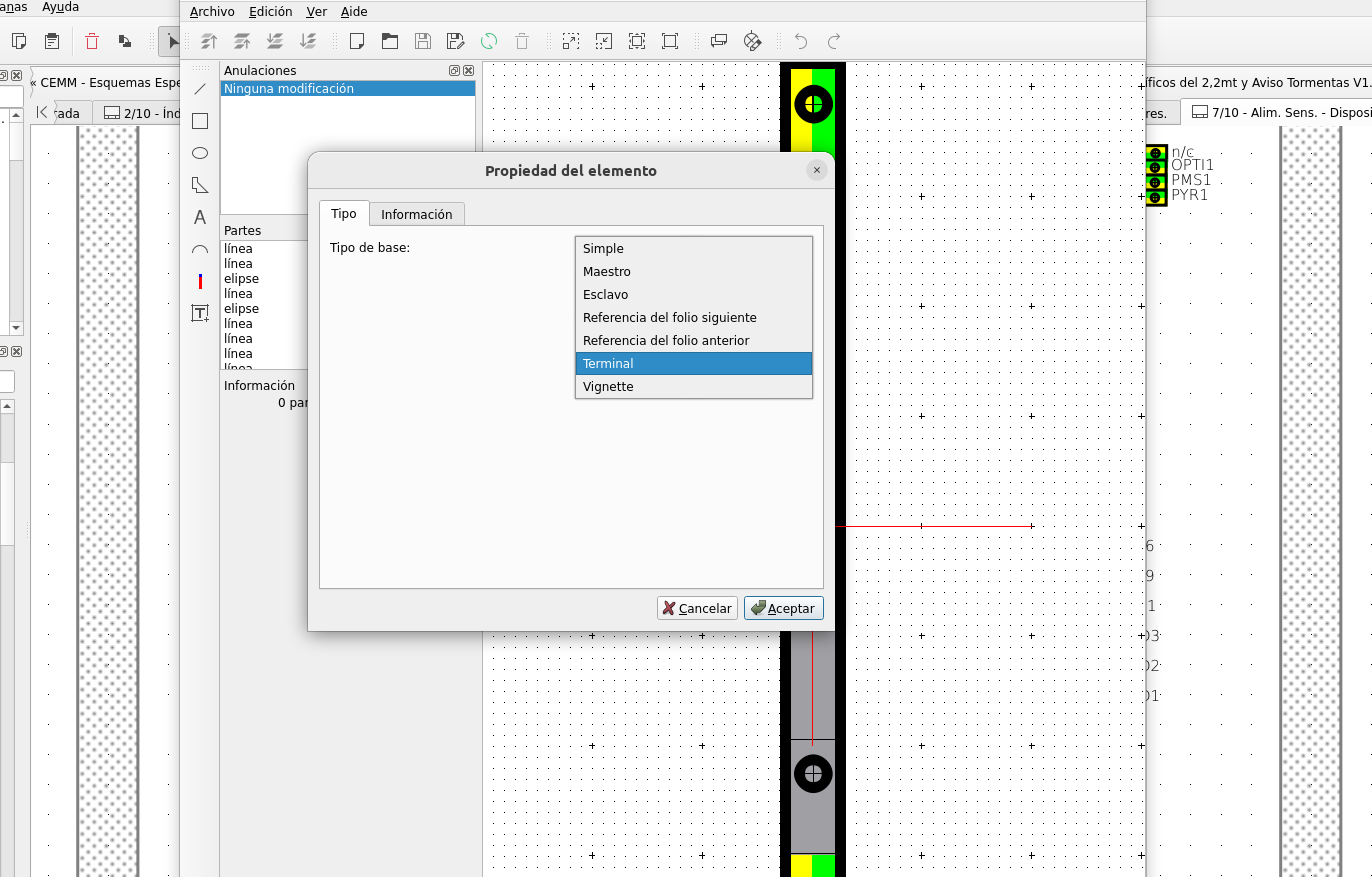

8 (edited by marin.molina 2022-11-24 17:42:33)
Re: Differences in element information in versions 0.90 and 0.80
Hello everyone.
I have the same "problem", but in my case I solve changing the property "terminal" to "simple" at the edition of the element.
Attachment icon Captura - Cambio de propiedad termnal to simple.png 150.01 kb, 86 downloads since 2022-11-24
