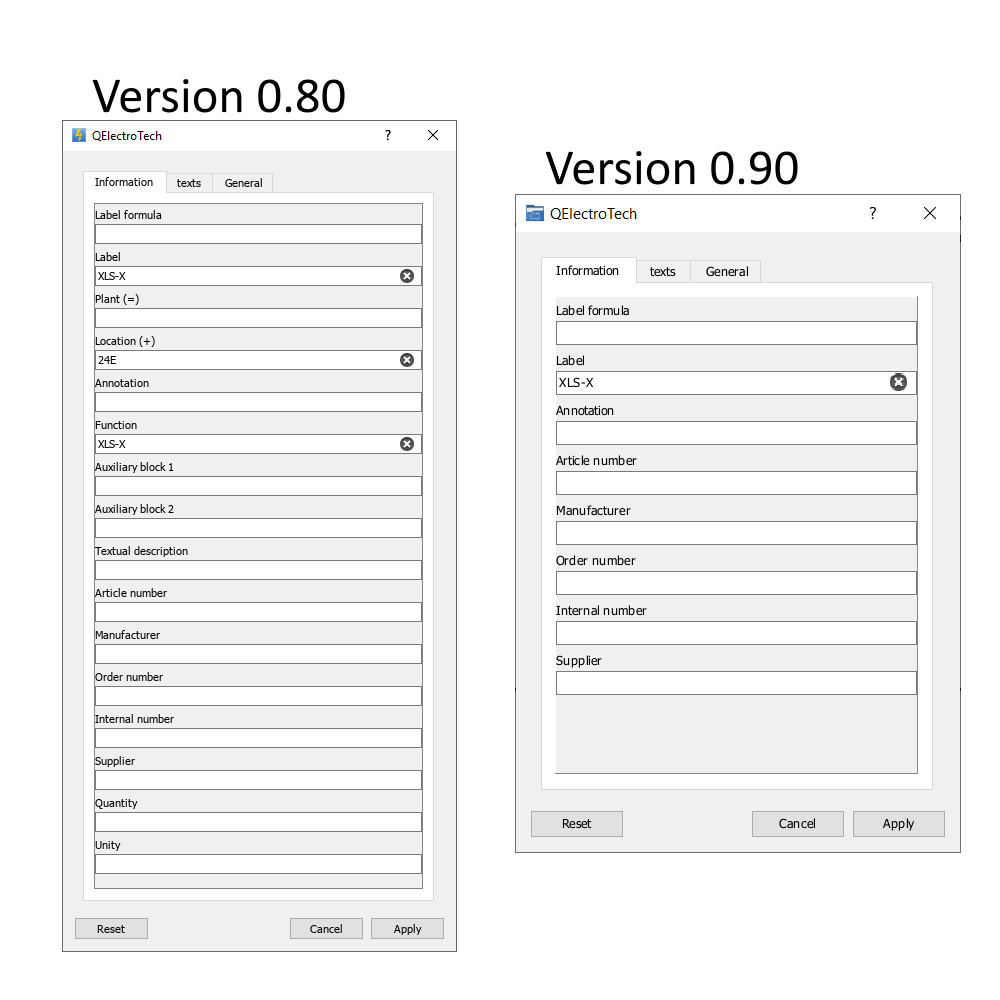

Hello!
In the QElectroTech V 0.80c when I click on a terminal block the information tab has a lot of properties that are missing in the QElectroTech V 0.90.
For example the "Location", "Plant", "Function", ... properties are missing in the latest version.
Is this a bug or is this something that will be the new reality?
Is it possible to edit the old properties in the new version?
Thank you for any reply.
0_80vs0_90.png, 51.17 kb, 1000 x 1000

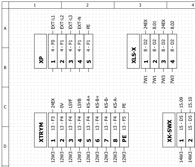

Hello!
Screen.png, 155.65 kb, 1989 x 1310

Re: Differences in element information in versions 0.90 and 0.80
Hello, these information was removed in 0.9dev because I'm currently working on the terminal block feature, and all this information will be owned by the terminal block and not by each terminal who compose the block.

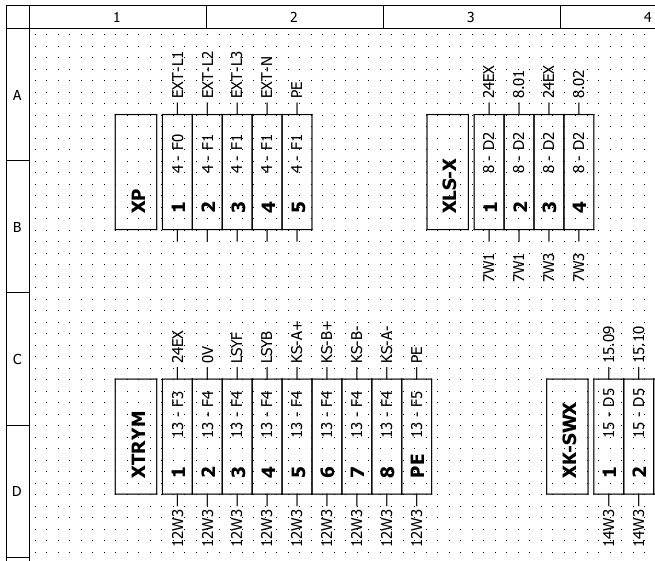

Thank you for the response.
I wrote a simple Python program that is going through all terminals and then draw all terminal blocks.
For this to work I was using the "Function" and "Location" property of the terminals.
Will the terminals in the future versions have some additional properties?
How will you know which terminal is in which position and which terminal is in which terminal block?
Terminals.png, 18.48 kb, 655 x 561

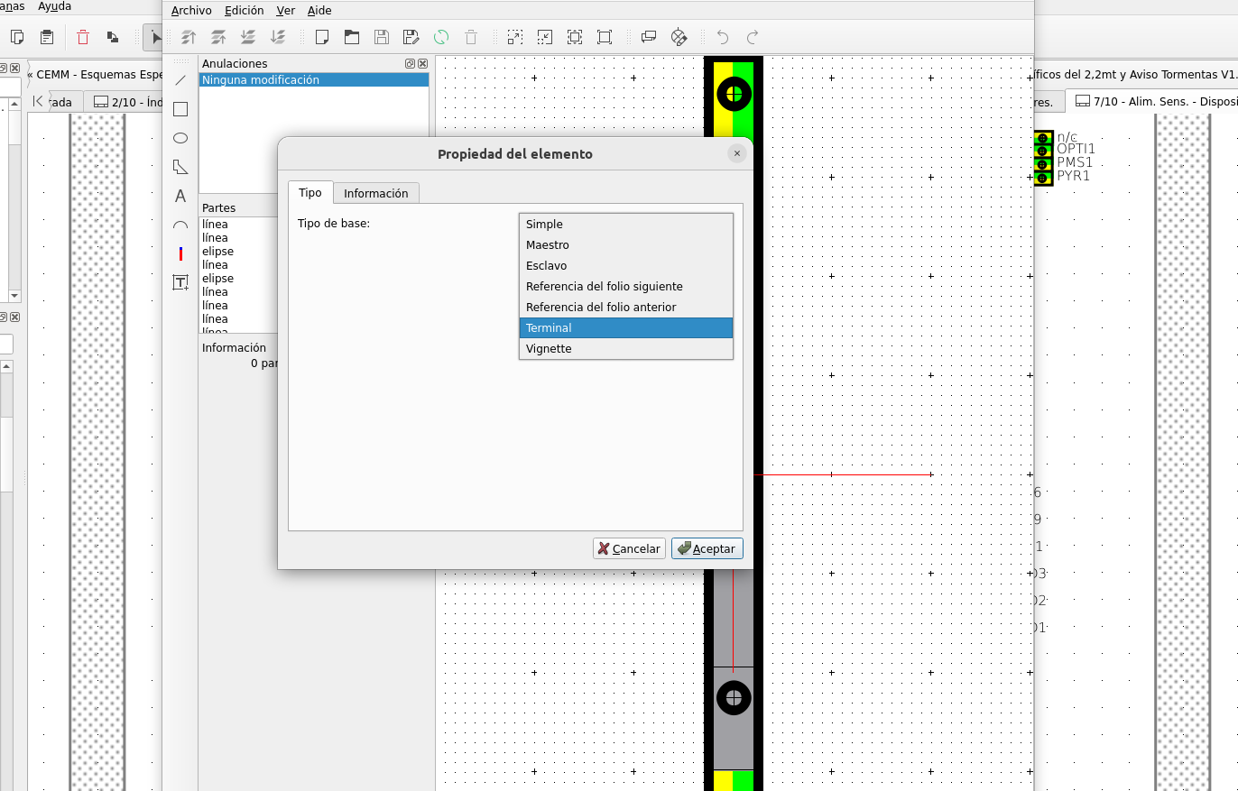

Hello everyone.
I have the same "problem", but in my case I solve changing the property "terminal" to "simple" at the edition of the element.
Captura - Cambio de propiedad termnal to simple.png, 150.01 kb, 1372 x 877
