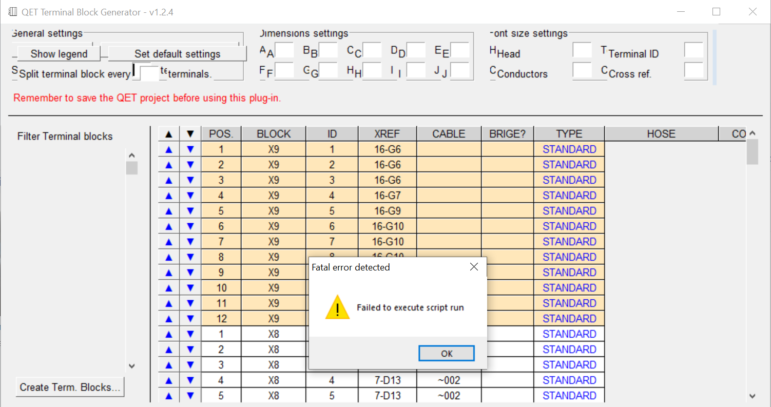

On Windows 10 I tried versions 1.1.7 (works and generates the block) and 1.2.4 (does not work). Both launched from QET.
In each case I renamed and moved the portable executable to:
C:\Users\Jakub\AppData\Roaming\qet\
I whitelisted version 1.2.4 (windows defender complained about it). 1.2.4 Starts a new window and shows detected terminals, but then the error window is displayed: "Failed to execute script run".
https://pasteboard.co/K2c1RsA.png
How could I resolve this?

version 1.2.5 solves the problem?
Re: Planning to record a tutorial for the plugin; encountered a problem.
I have the same problem with the precompiled qet_tb_generator-1.2.5.exe. QET is able to find it after I put the (renamed) file into the C:\Program Files\QElectroTech\bin folder.
