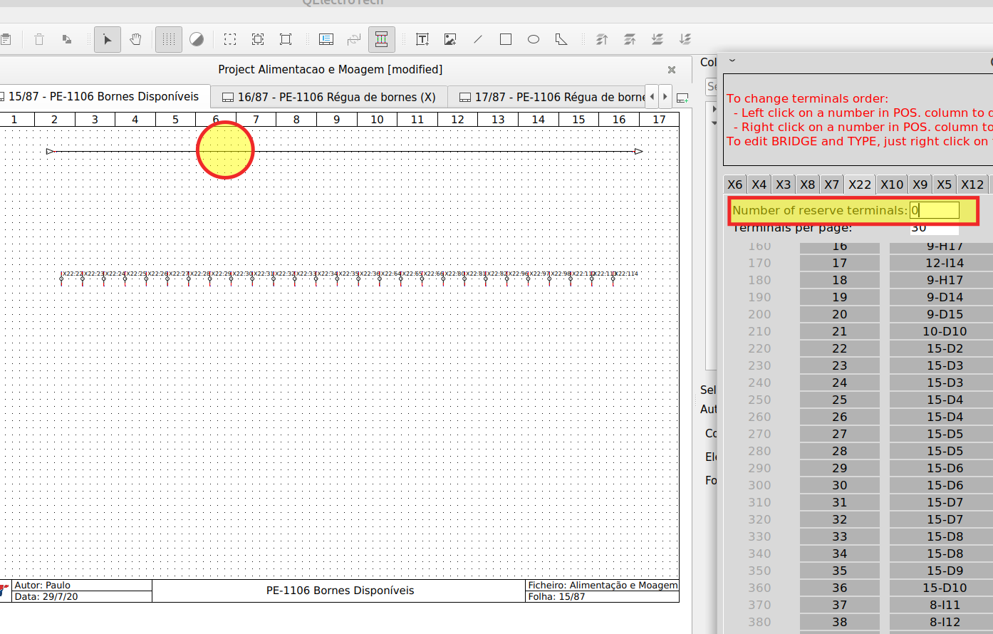

the problem is that if a page has some terminals, must have a minimum of one cable.
The next version will fix it, but for now there are 2 solutions:
1. Draw some cable (see the image as an example)
2. For reserve terminals, there are a field in the plug-in that allows it without drawing one-by-one at the schema. The field is different for every terminal block.

10 (edited by palhenrique 2020-08-31 16:55:22)
Re: (Solved)Problem with QET_TB_GENERATOR v1.1.6
Hello Unalcalde!
Thank you very much.
QET has an excellent team of developers! Congratulations again.
