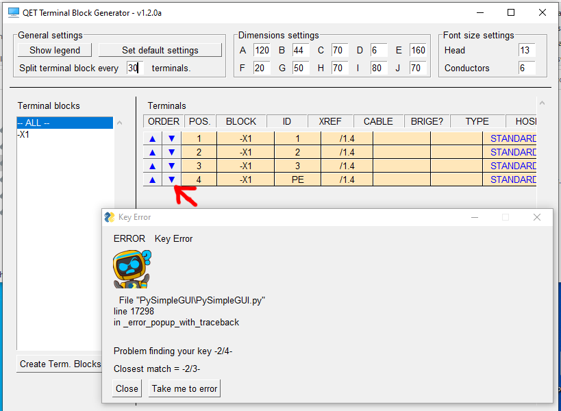

I'm currently testing the new Terminal Block Generator using the qet_tb_generator-1.2.0a.exe on win10 and I think I
found some bugs:
- In the "Order" column clicking on the last down arrow, an error message "Key Error" appears. (see picture keyerror.png)
- after I have successfully created a terminal block, I cannot open the project again with the qet_tb_generator. The program
   crashes after choosing the projekt with an error message.
Achim

Re: Suggestions and bug for new coming version
please, send me the project that you can't open again.
(raulroda8@gmail.com)
Thanks
11 (edited by unalcalde 2021-04-27 23:11:41)
The beta version 1.2.0b solves:
- Error in Windows when closing the app
- Error opening projects with edited logo. After changing the logo, del XML file use new namespaces tag, but those are not defined at the XML head. Now the plugin adds automatically the definition of every namesapce detected but not defined.
