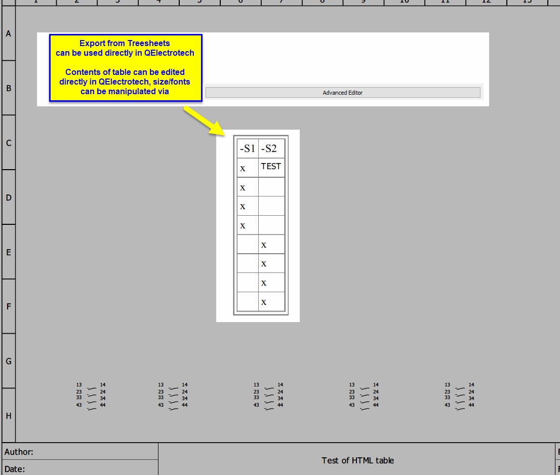

Just sharing a discovery...
Been using Treesheets for years...
What is it; freeform text organizer - works for everything
http://strlen.com/treesheets/
TreeSheets exports to HTML
(you can choose to export to HTML each time you save a file)
HTML can be used directly in QElectrotech
Very good / efficient for creating e.g. tables in Folios
Cheers.
SCREENSHOT
2021-04-02_20-00-35.png, 41.08 kb, 1106 x 938

Same hacks if you want to add online pdf link in your generated project pdf, or internal pdf page for documentation parts or process.
Or add image, but isn't useful since version 0.3.
