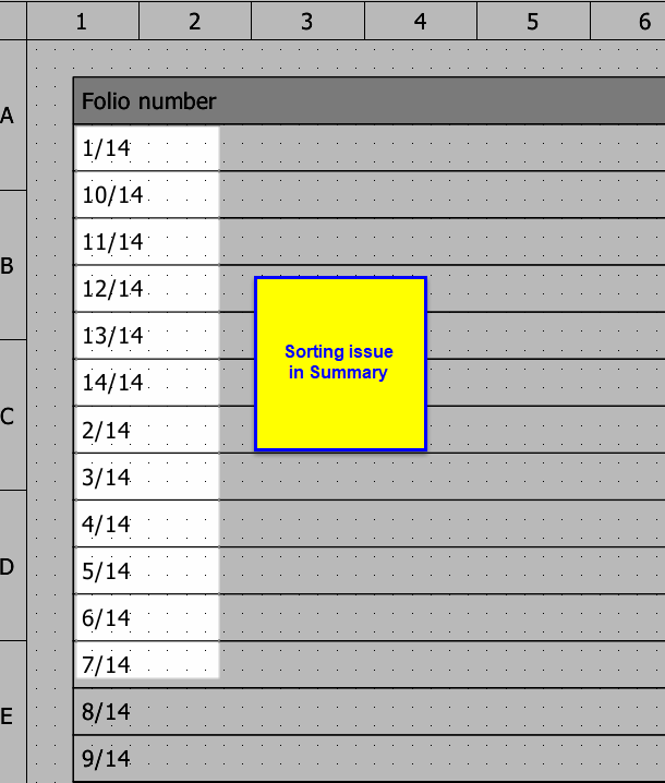

Tnx to developers / volunteers for the great / flexible Summary function introduced in v 0.8 - which allows to edit/modify the layout of the Summary. (makes the output even more professional and gives the software more generic uses, than being locked to specific text / columns - previously; Folio | Title | Plants | Location | Rev | Author | Date)
Tried to register for Mantis bugtracker to report the following as a bug (still waiting for confirmation e-mail)...
However, I struggle with the sorting / order of folio numbers.
SCREENSHOT ATTACHED
Anyone figure out a fix / workaround for this?
EDIT:
Might give this one a try.
https://qelectrotech.org/forum/viewtopic.php?id=1968
EDIT #2
Adding the '+ 0 ASC' after "folio" in SQL request also results in correct order:
         SELECT folio, author, date FROM project_summary_view ORDER BY folio + 0 ASC, author, date
