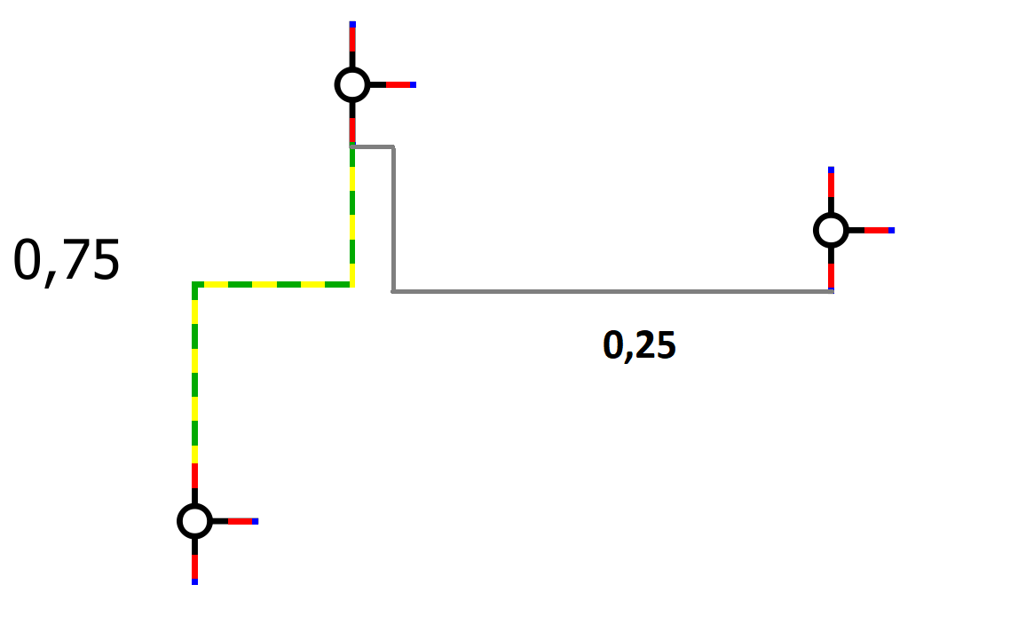

Good morning Xander, scorpio810,
I set the color for PE to yellow-green (0.75) but the second wire color should be grey (0.25). Both wires should be connected to one terminal. And this ist not possible (for me).
@scorpio810:
What do you mean with "without terminal property"? Should I set the comonent properties to "single part"?
I add a small paint picture what I try to create in qet.

Re: Unterschiedliche Leiterfarben an einer Klemme
@scorpio810:
Yes.
