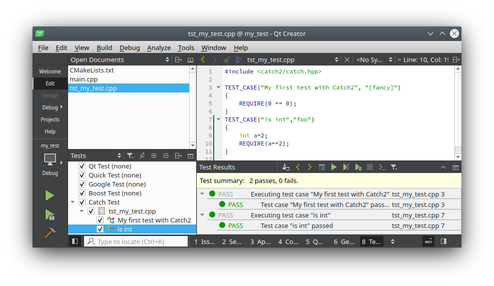

Re: [tests] test code C++
my first test, now getting into the QET code
(i know it's a stupid test)
Screenshot_20201207_143436.png, 123.16 kb, 987 x 572
