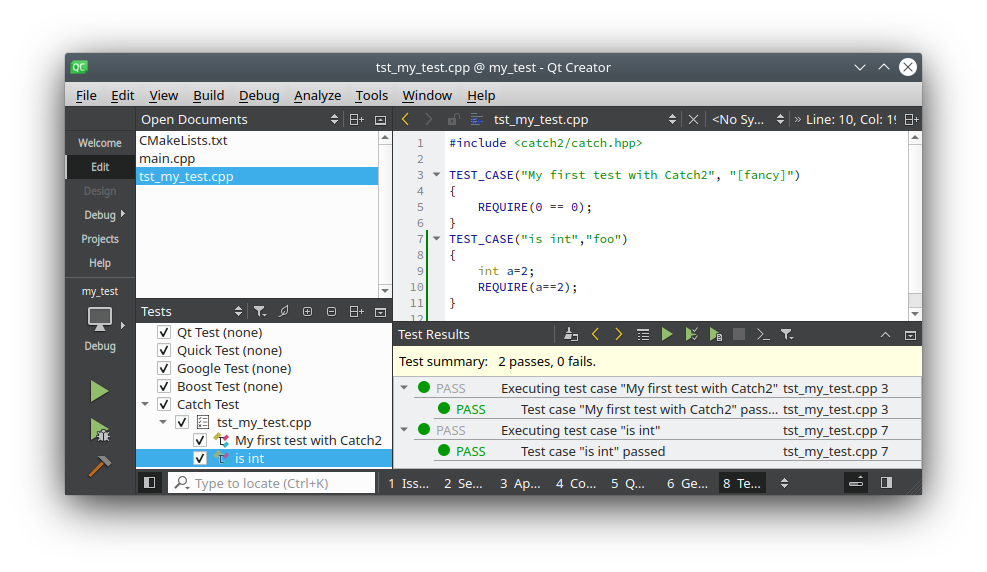

Re: [tests] test code C++
my first test, now getting into the QET code
(i know it's a stupid test)
Screenshot_20201207_143436.png, 123.16 kb, 987 x 572
ok i was able to make a test qet
extract the zip in the qet root folder
so that you get this
├── sources
│   ├── autoNum
├── Tests
│   └── tests
│       ├── CMakeLists.txt
│       ├── CMakeLists.txt.user
│       ├── main.cpp
│       └── tst_My_test.cpp
run qtcreator
File >  open =>
Tests > tests > CMakeLists.txt
note:
before this gets into the repo i will do some testing
