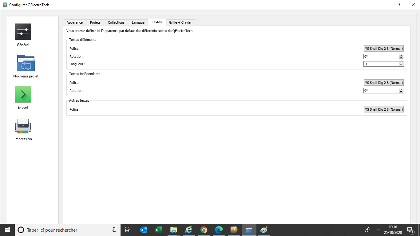

239 (edited by S.DEFFAUX 2020-10-25 11:20:33)
Re: Nouveautés de la version de développement 0.8
j'ai des soucis avec les widget
config.jpg, 243.11 kb, 1366 x 768

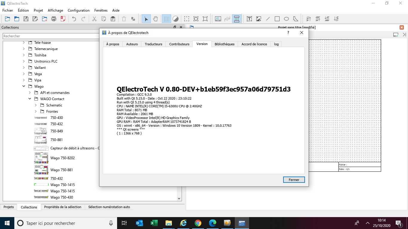

la suite
pb affichage.png, 71.9 kb, 1366 x 768
241 (edited by De-Backer 2020-10-25 13:25:26)
@ S.DEFFAUX
code:
https://git.tuxfamily.org/qet/qet.git/t … .cpp#n1769
void QETApp::configureQET()
    // determine the parent widget to use for the dialog
    // determine le widget parent a utiliser pour le dialogue
    QWidget *parent_widget = qApp->activeWindow();
    // create dialogue
    // cree le dialogue
    ConfigDialog cd;
    cd.setWindowTitle(tr("Configurer QElectroTech", "window title"));
    cd.setWindowModality(Qt::WindowModal);
    cd.addPage(new GeneralConfigurationPage());
    cd.addPage(new NewDiagramPage());
    cd.addPage(new ExportConfigPage());
    cd.addPage(new PrintConfigPage());
    // associates the dialog with a possible parent widget
    // associe le dialogue a un eventuel widget parent
    if (parent_widget) {
        cd.setParent(parent_widget, cd.windowFlags());
    // display the dialog then avoid linking it to any parent widget
    // affiche le dialogue puis evite de le lier a un quelconque widget parent
    cd.exec();
    cd.setParent(nullptr, cd.windowFlags());
    qDebug() <<"configureQET"<<cd.size();
Debug: configureQET QSize(1400, 1000) (../../qet/sources/qetapp.cpp:1802, void QETApp::configureQET())
the 1000 is your problem, right?
Mod code:
to
        cd.resize(parent_widget->size());
Debug: configureQET QSize(1280, 720) (../../qet/sources/qetapp.cpp:1803, void QETApp::configureQET())
but this is a problem for large screens.
        cd.setMaximumSize(parent_widget->size());
is ok
https://git.tuxfamily.org/qet/qet.git/c … f343adb020
le nom des dossiers des éléments importé dans le projet ne sont plus traduit
no translate.png, 94.35 kb, 1366 x 768

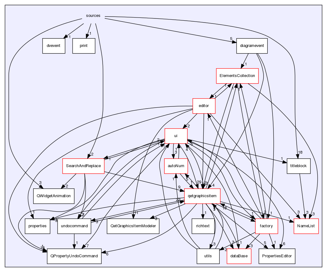

@S.DEFFAUX I skip this one
Have you ever wondered why some bugs take a long time to fix?
dir_08d237fc27d4ecd563f71c5d52f2fecc_dep.png, 199.77 kb, 1045 x 869
Corrigé.
Joshua wrote:
Corrigé.
