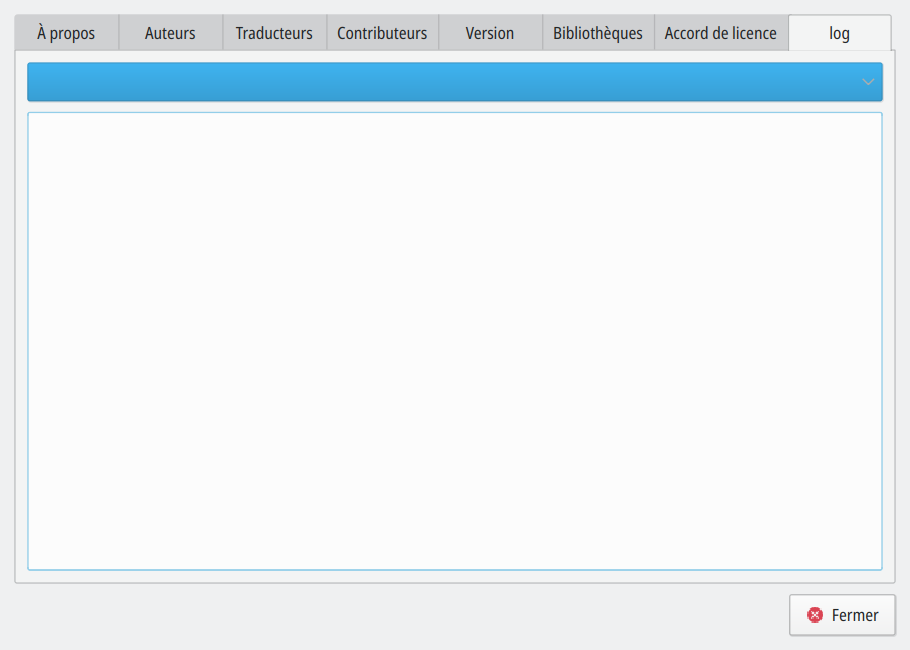

Re: removing orientation for element.
Great, thanks Simon, but here not log..

Tried with Qtcreator, same thing with :
git pull
mkdir build && cd build
qmake ../qelectrotech.pro
time make -j48

Nothing QETApp::configDir()
No log in my ~/.qet/ directory.

Strange .... work on macOS VM..
20:26:29.930 Info: Start-up
14 (edited by De-Backer 2020-08-31 22:39:53)
De-Backer wrote:
put a breakpoint in main.cpp lines 119 and 112 and test if you see this.
mmm.... file dir .... //...log
Fix ?
see:
https://git.tuxfamily.org/qet/qet.git/c … 30d3e75724
WIN10 VM :
15 sec to load all Elements collection

see
https://git.tuxfamily.org/qet/qet.git/c … a44c426f82
for -win32-readytouse.7z
I build and pushed all packages, please try it.
I checked on Flatpak VM, is ok ~ 2 s to launch QET.

No time these next days to study why on my Debian SID machine I don't have the logs.
My setup launches QET too quickly which is ashamed to show its logs for fear of making those under Windows cry, uhuhu.
you think we could also find the versions of third-party libraries like KwidgetAddons, KcoreAddons, ECM?
Good work Simon these logs will help us a lot.

when you do have the time launch to qElectroTech through the shell and at the directory dire.
