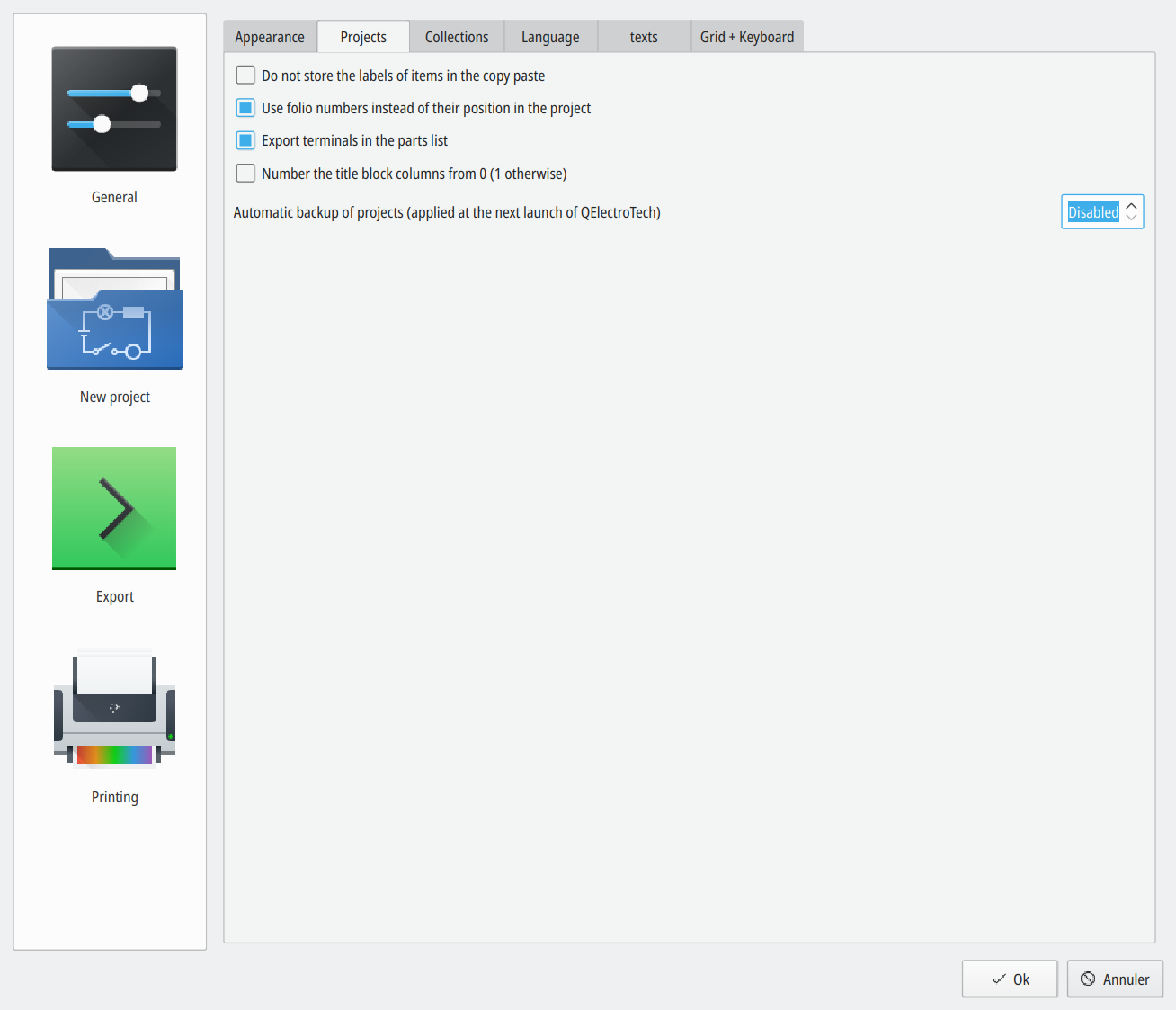

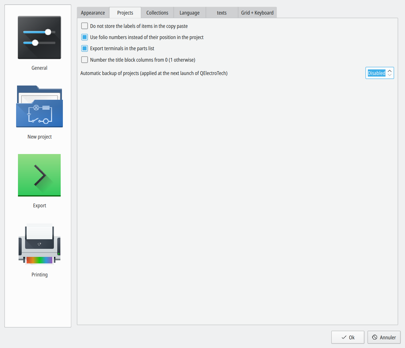

In General settings -> project try disable autosave.
35
Re: continuous blocks
SSD
saving is disabled, the problem remains
36
josaar2001 wrote:
SSD
