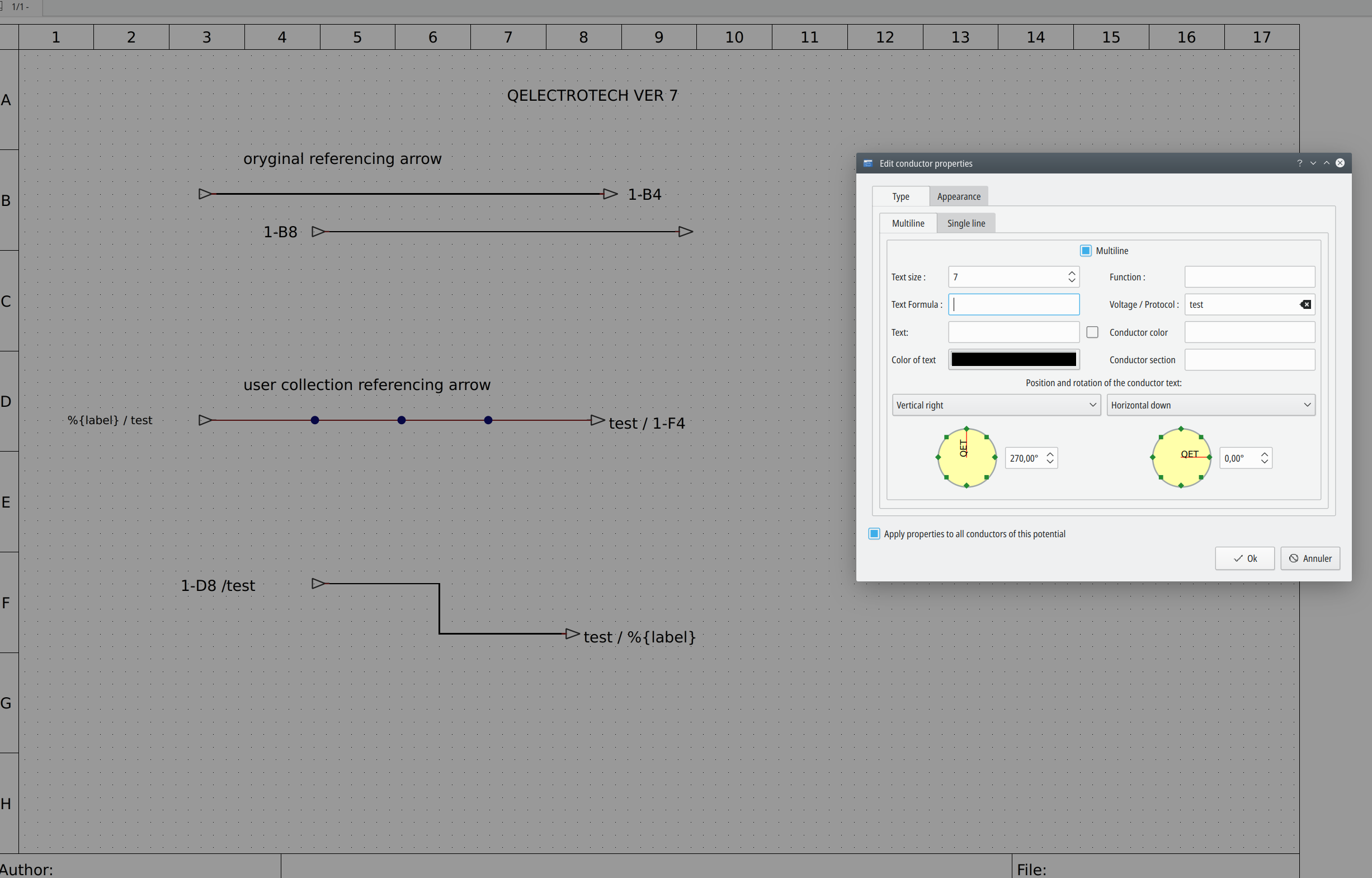

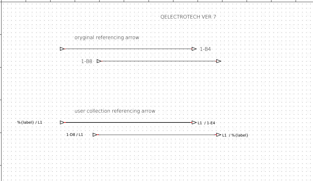

[img][/img]

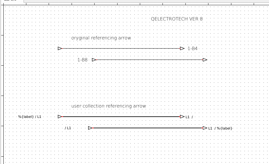

[img][/img]

Thanks for report this issue, maybe since we change minus by underscore?
https://git.tuxfamily.org/qet/qet.git/c … 5fa9a304f7
If I try with %{function} seems working.
%{tension_protocol} or %{tension-protocol} is missing in this widget and wrote %{void} ?!...
There also seems to be a bug with composite text and %{label}.
https://download.qelectrotech.org/qet/forum_img_2/0.8-bug_check_report_folio.png
