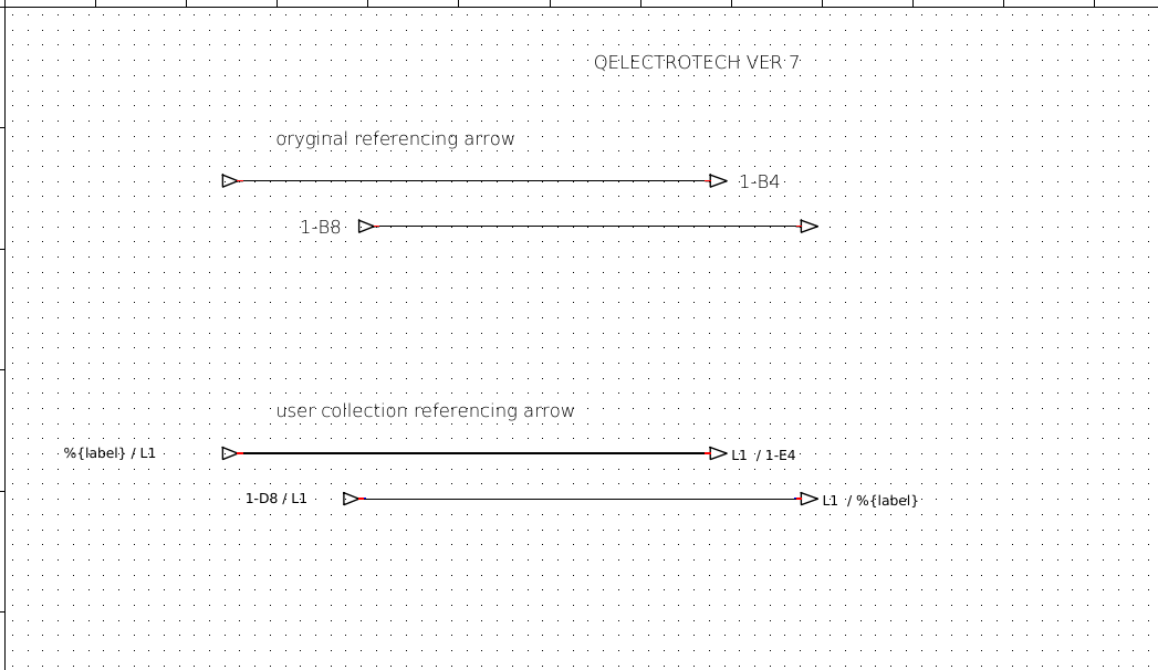

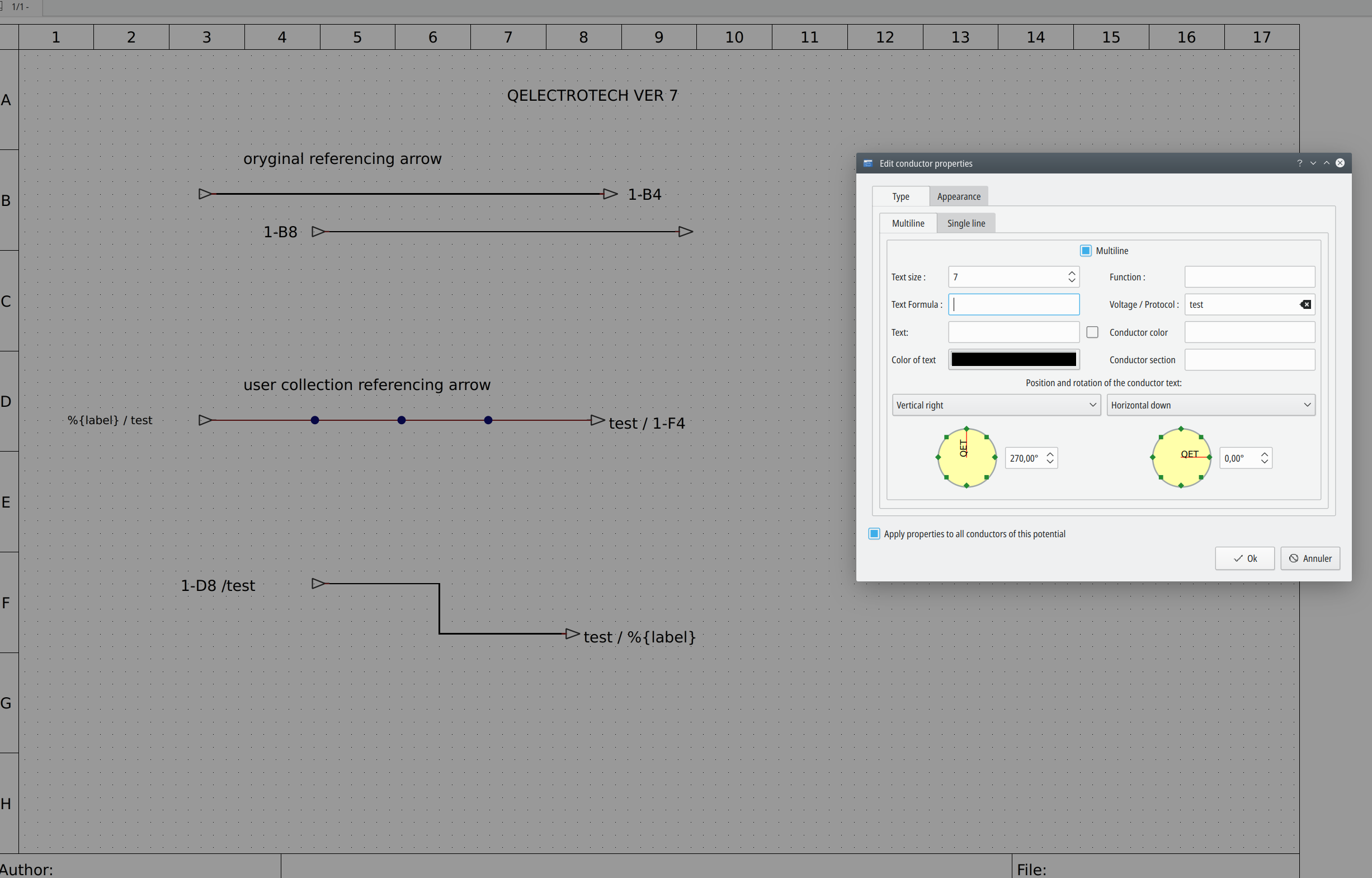

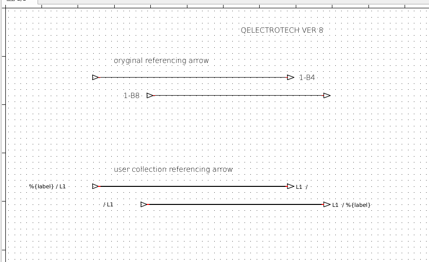

I have problem with reference folio arrow.
In ver 7 I customise reference arrow by adding %{tension-protocol}  / %{label} to get more information
in ver 8 I don't get crossing information in my elements.
When I copy crossing arrow to user collection and don't change anything crossing reference works fine but if I change anything for example move dynamic text file "/" crossing stop work. Even if I undo changes crossing don't work.
I use this crossing functionality to make PLC symbols and in ver 8 crossing reference in my PLC symbols don't work too.

[img][/img]
qelectrotech_ver7.png, 23.17 kb, 1047 x 606
Re: reference folio ver8
[img][/img]
qelectrotech ver8.png, 20.12 kb, 879 x 537

Thanks for report this issue, maybe since we change minus by underscore?
https://git.tuxfamily.org/qet/qet.git/c … 5fa9a304f7
If I try with %{function} seems working.
%{tension_protocol} or %{tension-protocol} is missing in this widget and wrote %{void} ?!...
There also seems to be a bug with composite text and %{label}.
https://download.qelectrotech.org/qet/forum_img_2/0.8-bug_check_report_folio.png
