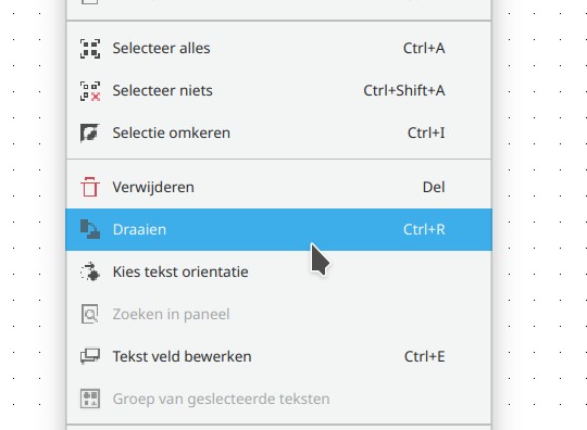

For rotate selection (Shortcut is Space)
does not work for language nl be (this has been since 2019)
file qetdiagrameditor.cpp at line 545
m_rotate_selection->setShortcut(QKeySequence( tr("Space")));
test mod Space to Ctrl+R works
Updating 'lang/qet_be.ts'...
    Found 2294 source text(s) (1 new and 2293 already existing)
    Kept 1 obsolete entries
m_rotate_selection->setShortcut(QKeySequence(tr("Ctrl+R")));
I cannot find the Space key in qt nl be.
does anyone know the key for space?
I have tested "spatie",  "Spatiebalk"
A bug in Qt?
edited :add Screenshot of test with Ctrl+R
Screenshot.jpg, 29.72 kb, 540 x 396

After test,
m_rotate_selection->setShortcut(QKeySequence( tr("SPACE")));
work well for nl be local and also for french.
I will try for all local and if it's ok I commit the change.
Thanks for report

Re: Shortcut (Space key) for language nl be does not work.
Work well for every local. Pushed to git master.
