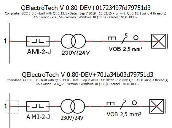

Yesterday I installed the latest DEV version. I was surprised to see that the quality of the project sheet content has deteriorated, especially when zooming in. It looks like when vector graphics are replaced with bitmap graphics.
Am I doing somthing wrong?
See attachment, first the new version then the previous one.

You could change font policy in settings, select a vector graphic policy, just reload your projects to see the change aplied on the fly.

Only change are on Qt 5 Framework  Qt 5.13.0 -> 5.13.1.
Re: Project display deteriorated
You 're right, thanks to report it.
This problem seems to affect only the MS Windows version.
Please try the latest versions compiled for Windows. I just downgraded the Qt 5 version to the old 5.12.3 environment.

Upgrade to Qt > = 5.13. break font scale on Windows :
I tried today again with new Qt 5.14.0 and  saw the same thing only on windows platform..

Is perhaps a font issue :
Added QGuiApplication::setHighDpiScaleFactorRoundingPolicy(Qt::HighDpiScaleFactorRoundingPolicy::RoundPreferFloor);

A workaround to fix this issue on MS Windows with Qt 5.14.0 is to replace all Sans Serif default font by MS Shell Dlg 2 in all elements and all collections XML.. Btw users need hack our XML project also and replace Sans Serif police.
