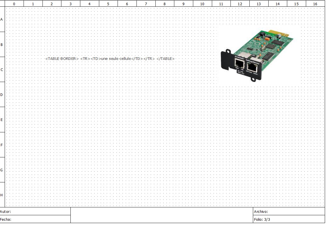

Hi everyone, I am a new user moving from Design Spark Electrical which is -or used to be- a small version of Sw Electrical. Hopefully I can make Qelectrotech my design program in the future.
I am having some trouble trying to "render" html text inside QElectrotech. Is there anything that needs to be configured to make the entered text show on the page like a table ? What I get is exactly what I enter but not a table.
<TABLE BORDER>
<TR><TH>DISJONCTEUR </TH><TH>D1</TH><TH>D2</TH><TH>D3</TH><TH>D4</TH></TR>
<TR><TD>SECTION </TD><TD>mm² </TD><TD>mm² </TD><TD>mm² </TD><TD>mm² </TD></TR>
<TR><TD>COURANT </TD><TD>A</TD><TD>A</TD><TD>A</TD><TD>A</TD></TR>
</TABLE>
I have read the posts and also saw the Yutube video, but I don´t know what is missing. I am running 0.8 on Windows 7.
I almost forgot to add there is a "preview" of the table by hovering the mouse on top of the text.
Thanks

Hi, see attached screens:
Add a text and right clic -> Edit the text field, is launch text editor.
Now put your HTML code in source field.
https://download.qelectrotech.org/qet/forum_img_2/html_text.png
https://download.qelectrotech.org/qet/forum_img_2/html_text_render.png
