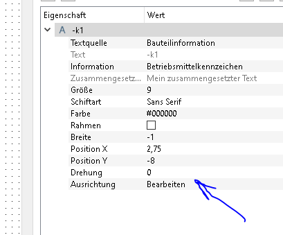

I am now unbroken for debugging on Linux. That makes a lot of things easy.
But there is still a bug. If you put on text alignment and then change the alignment from top to button something happens when you move the master.

Re: feature set xref slave position
Because the Xref is update When you move the master.
What you need to do is when you change the alignment properties, you need to force the update of the displayed Xref

Hi
i have fix the issue, can you test it.
Attachment icon 0001-bugfix-XREF-Update-when-Text-Alignment-used.patch 925 b, 326 downloads since 2019-11-16
added, thanks Stromie.
