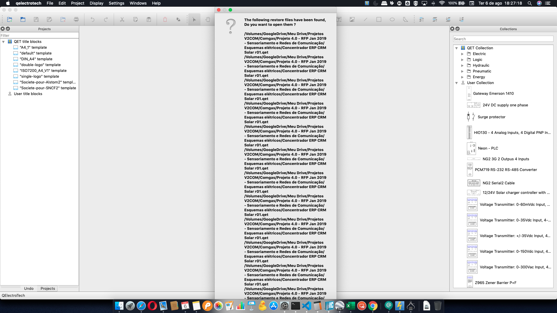

Hello Qelectrotech team
I'm using it on version 0.5, but now i migrate to new 0.7 version for MacOS.
But since last crash, every time I open it a pop-up low of the file restore open. I open the app (lauching it from applications or double-click a qet file) the restore list double size. It looks like a bug for MacOS version
My MacOS version is:
10.14.6 (18G84) (Mojave)
machine: MacBook Pro (Retina, 13-inch, Mid 2014) - MacBookPro11,1
Thanks in advance
Captura de Tela 2019-08-06 às 18.27.18.png, 636.65 kb, 1920 x 1080

Hello Aopenna,
thanks to report this issue.
Is work for you and launch QET with the project you clicked on the file?
Here is launch program without open the project I selected by clicking on folder.
Btw, backup files is stored on ~.local/share/stalefiles/QElectroTech on Linux.
C:\Users\username\AppData\Local\stalefiles\QElectroTech on Windows.
I don't remember for macOS where stalefiles folder is stored for cleaning up.
Edit :
/Users/username/Library/Application Support/stalefiles/QElectroTech/
