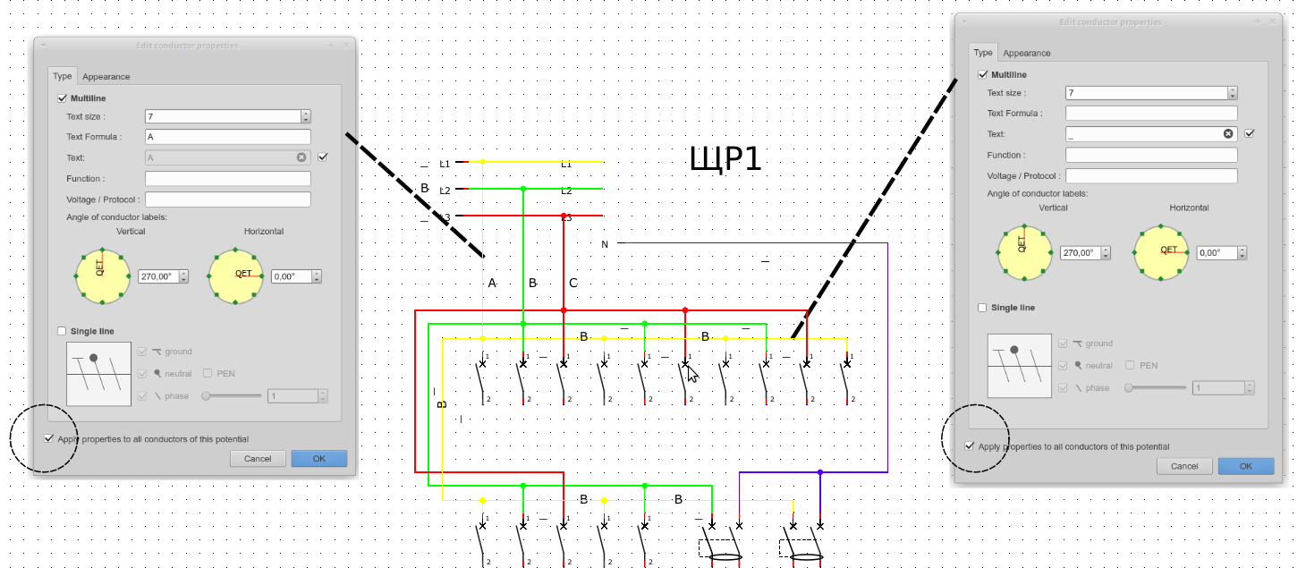

Re: BUG?: Exporting to DXF - a "List of Folios" crashes QET
Hello polygon13,
I have checked the connections, I noticed that some compounds have different properties (screenshot) and thought it might be because. First, I removed all connections and redrawn while I first drew a connection and assigned the property for this connection and further connected. Pages 2 and 3 of the DXF export has worked. After I have removed the connections on the 1 page and redrawed I had at the 1 page when exporting the same problems that the circuit was not displayed correctly. Funny is when I copy the circuit of page 1 and 2 on a new page or in a new project, the circuits after exporting synonymous no longer displayed correctly.
Best regards
Stebo
screenshot 2018-03-16 22:03:28.png, 124.14 kb, 1460 x 635
